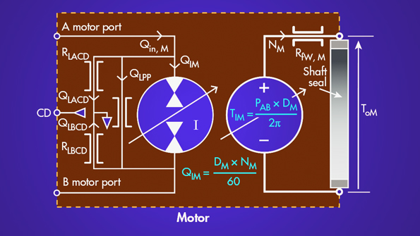

For now, it should be apparent that the similarity between a pump and a motor should result in analytical schematics that are similar. Indeed, that is exactly the case. The analytical schematic is essentially the mirror image of the pump. Figures 4 and 6 are the analytical schematics for Type-1 and Type-2 hydraulic motors. They should be compared to Figures 3 and 5. The significant difference between a pump and a motor is the direction of energy flow.

6. Just as with the Type-1 motor, the Type-2 motor is the mirror image of the Type-2 pump. In this figure, though, the shaft seal is shown schematically.
A hydraulic machine, say a motor, works like this: If a flow source is connected to the motor, the immediate reaction is that the pressure rises because the motor is not moving. However, in a few milliseconds, it rises enough to overcome the friction, and the motor and its load accelerate. Speed continues to increase until all of the flow goes into the motor’s internal displacement chambers, at which time the motor has reached its steady-state speed. That is, the pump output flow and the motor input flow are balanced and equal.
The motor’s speed is controlled by the output flow from the pump. If pump flow increases due to greater displacement or input speed, the pump output flow increases, and the motor will accelerate. This is one of the most fundamental principles of hydraulic machines. Moreover, in every pump there’s a motor, and in every motor there’s a pump.
