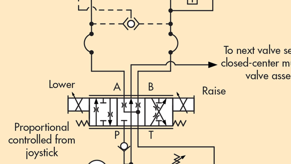

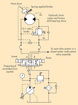

When a drill-rig operator started the unit and commanded the top drive head to be lowered, it dropped uncontrollably, damaging the drill bit or buckling the drill string.
A 65-ft.-high drill rig, mounted on a freshwater barge, was allowing its top drive head to drop uncontrollably. The circuit controlling this function shows (see illustration) both a brake (counterbalance) valve and a hydraulically controlled mechanical brake on the hoist function. The systems’ power unit was mounted close to the deck, with its A and B line hoses going up to top drive’s hydraulic motor. The brake and shuttle valve were plumbed close to the motor, which lifted and lowered the drill drive head.
When the operator first started the unit and commanded the top drive head to be lowered, it dropped uncontrollably, damaging the drill bit or buckling the drill string (pipe). The operator also heard a “ratcheting noise,” as if the mechanical brakes were attempting to grab. This problem also occurred after the hoist was raised and locked into place with the mechanical brake, and not operated for about an hour.
The operator found that he could raise the top drive head first and then command it to lower, and it seemed to work okay, but it started jerking for a few seconds. No oil leaks were visible in any of the plumbing from the motor down to the directional valve. What do you think was causing the erratic operation?
