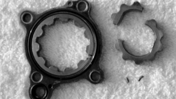

Rugged hydraulic pumps usually will continue to perform fairly satisfactorily even when they begin a failure mode, but don’t wait until they fail completely before changing them. Catastrophic failure of the pumping elements can introduce thousands of metal bits and pieces into the system that will cause many future problems.
