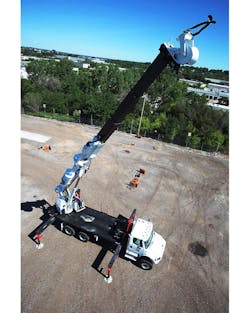

Boom Design and Functions
The D105 features a four-section proportional steel boom that extends from its 28 ft., 6 in.-retracted length to a maximum length of 95 ft. for a 107-ft. maximum tip height. At the tip is one upper sheave, with two lower sheaves for reeving up to five parts of load line. Mounted at the base of the boom is a winch that provides a single-line pull of 12,000 lb and is driven by a two-speed piston motor. The motor has a 68 cc displacement in low-speed mode and 30 cc in high-speed mode, driving the winch through a 48:1 ratio planetary reducer.
A double-acting long-stroke hydraulic cylinder with a 7.50-in. bore and 6.00-in. diameter rod provides smooth and stable boom elevation. A counterbalance valve prevents the boom from falling in case of hose failure. Boom extension is provided by a two-stage cylinder attached to the largest boom section, with a proportional cable extension system driving the outermost boom sections. The cylinder’s larger bore is 5.38 in. with a 4.64 in diameter rod, while its smaller bore is 3.63 in. with a 3.00 in. diameter rod.

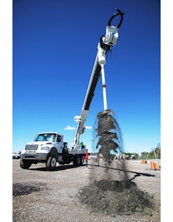

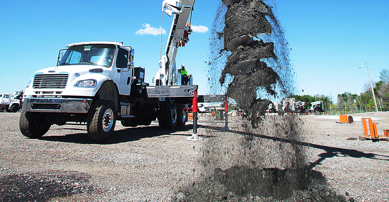

A Powerful Auger
An essential component of the machine’s dual purpose design is its high-torque (20,000 lb.-ft.) auger, which can be operated at two spin speeds. A low speed (35 rpm) provides high torque for digging, while a high speed (80 rpm) can be used to quickly fling dirt from the auger. This eliminates time-consuming manual scraping and improves productivity compared to a conventional crane-mounted auger.
Designers used a two-speed variable displacement piston motor with minimum and maximum swashplate settings to achieve both the low-torque and high-speed requirements. The motor requires up to 55 gpm flow with 4,600 psi pressure. It is equipped with a solenoid coil that defaults to the low-speed, high-torque setting. When powered, the solenoid shifts to the high-speed, low-torque setting.
The auger is raised to its stowed position along the boom or lowered to be deployed by using the digger motor in conjunction with a rope connected to the stow bracket. The rope is wrapped around the shaft of the digger bit and either raises the mechanism into place or lowers it, depending on the digger motor’s direction of rotation. When it is in the stowed position, a latch driven by a 1½-in. bore hydraulic cylinder closes underneath it to secure it in the bracket.
The boom-mounted auger has a digging radius of up to 41 ft. and a digging depth of up to 16 ft., with the ability to handle augers up to 48 in. diameter. An auger bit up to 36 in. in diameter can be stowed on the side of the boom for transport. Actual pole diameters generally are slightly smaller than the auger, with taller poles requiring larger diameter bases.

The machine has two sets of down-and-out over-frame outriggers with a 20-ft. span. They are configured for full-span or mid-span operation. Their horizontal sections are driven by hydraulic cylinders having a 2.50-in., bore and 2.50-in. rod diameter, and 76-in. stroke. Vertical sections are driven by cylinders with a 4.40-in. bore and 2.50-in. rod, with a 27-in. stroke. For work areas that are tight or unusually shaped, the outriggers can be extended to different lengths on opposite sides. The machine’s control system then senses the outrigger positions and allows full capacity on the side where the outriggers are fully extended while preventing the turret from swinging over the side where the outriggers are partially or fully retracted.
