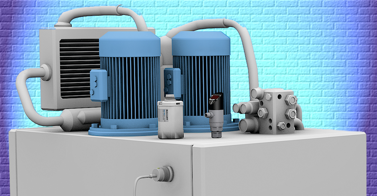

Most industrial hydraulic power units (HPUs) are located in less-than-accessible areas, such as cellars, utility rooms, or among other machines crowded around them. If an HPU is not easily accessible, it’s less likely to be closely monitored. This means oil level, temperature, cleanliness, and other important operating conditions could go undetected, potentially leading to a breakdown.
Monitoring the HPU should occur with the hydraulic system running. However, depending on its location, the HPU may have to be checked during scheduled downtime. The problem is that many undesirable conditions (especially low oil level during cycling) only emerge while hydraulic systems are in operation. Furthermore, if the HPU is remotely located, someone needs to physically check the status of fill levels for each HPU. In large facilities, monitoring dozens of hydraulic power units can be almost a full-time job.
Give HPUs the Smarts
Ideally, HPUs should be monitored continuously. This would obviously be an impractical use of labor. However, a practical and even more effective alternative is a smart HPU. A smart HPU has all of the elements of a traditional hydraulic power unit, but is fitted with electronic instrumentation to monitor key parameters. As a result, a smart HPU provides alerts that act as preventive maintenance to improve hydraulic-system reliability and service life, thereby reducing downtime. An added benefit is that the feedback from sensors can be used in statistical process control and other factory automation communications.
Adding electronic monitoring to an existing HPU or specifying it for a new application is a wise investment. And the good news is you don’t have to invest a ton of money all at once to upgrade all HPUs in your plant. Instead, you could start with the HPUs driving the most critical operations and fit them with only the bare necessities: fluid level and fluid temperature sensing.
Doing your homework can pay off, because some manufacturers offer level sensors with built-in temperature detection. Fluid contamination is also important; and although a wise investment, much of this online particle instrumentation can be expensive. Invest in technology that offers ease of expandability and integration in a step-by-step approach.
