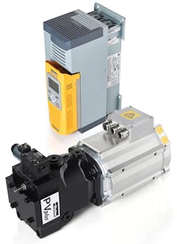

Parker Drive-Controlled Pump (DCP) and GVM-series synchronous motor are teamed with AC30 variable-speed drive to provide exceptional levels of control, from simple open-loop pumps and fans to closed-loop process line applications.
Parker Hannifin Corp., Cleveland, offers its Drive Controlled Pump (DCP) technology through its Hydraulic Pump and Power Systems Div., Columbus, Ohio. The DCP provides a synergistic approach that integrates hydraulic power units, electronic drives, electric motors, and hydraulic pumps to meet each local load demand within a hydraulic system. The product line integrates an ac drive unit, which includes variable frequency drives and electronics and either an induction or servo motor, matched to either a vane pump or axial piston pump or a combination of the two technologies.
Parker also offers fully customized DCP Solutions that may combine a variety of electric motor technologies, from induction to servo motors, partnered with a diversified selection of the company’s hydraulic pump technologies, including vane, helical gear and axial piston pumps. Parker’s custom field-tested control algorithms manage the electric motor’s operating torque and speed, producing the precise, variable pressure and flow required at any given point in the machine or duty cycle.
To provide the combined benefits of variable speed and variable displacement in a simpler package, Parker offers a version of its PVplus axial-piston pump, a dual-displacement pump that can be switched between two continuously adjustable settings. When combined with a variable-speed drive, it provides advantages that include lower acquisition costs for the motor and frequency converter, high operating pressure, high productivity, and high energy-efficiency.
