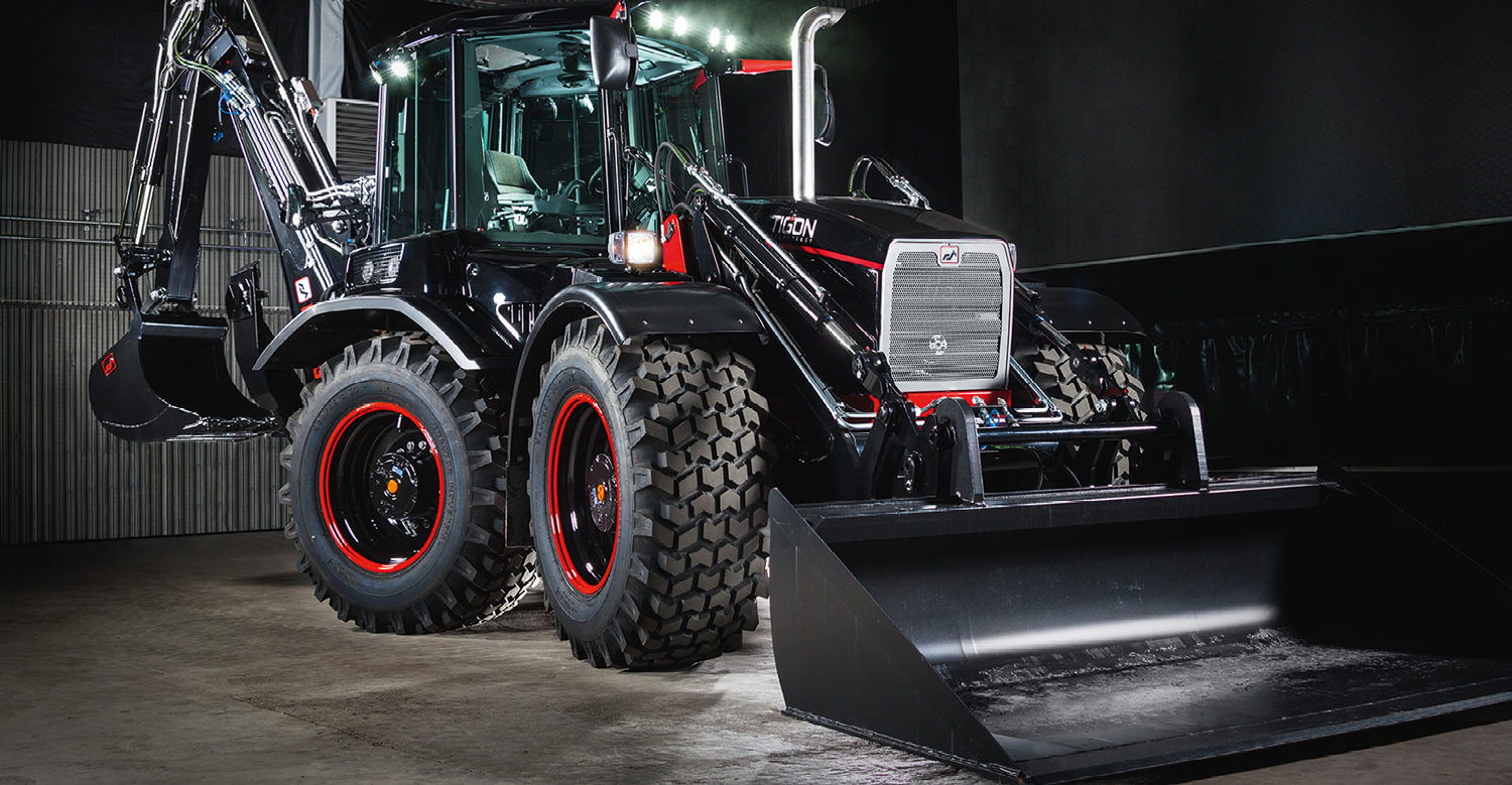

Huddig's new unit drives each wheel through a 610X two-speed hydraulically operated drive.

A specially designed loader backhoe from developed and manufactured by Huddig uses a hybrid hydraulic-electric drive at each wheel for improved traction control, maneuverability, and fuel efficiency than machines with conventional drives.
