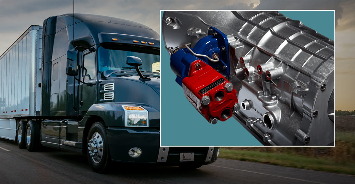

A power takeoff (PTO) provides an efficient means of driving a hydraulic without consuming under-hood space. Image courtesy of Muncie Power Products.

It may prove helpful to consider a practical application. For example, external power export solutions have come a long way from a stand-alone gas or drive a shaft-drivengenerator. Power management may be partially integrated into an existing truck design. A hydraulic generator is one answer; the concept is similar to the gasoline-powered stand-alone counterpart, but it’s more compact and versatile. These generators can be specified or retrofitted into existing work trucks with hydraulic circuits.
Without the gasoline power plant, size and weight can be reduced by 50%. In terms of maintenance costs, there are no gasoline engines to support and fewer environmental factors. Considering these dynamics demonstrates the importance of looking at the big picture and evaluating alternative solutions to minimize additional auxiliary equipment needs, maintenance issues, andoperating costs.
