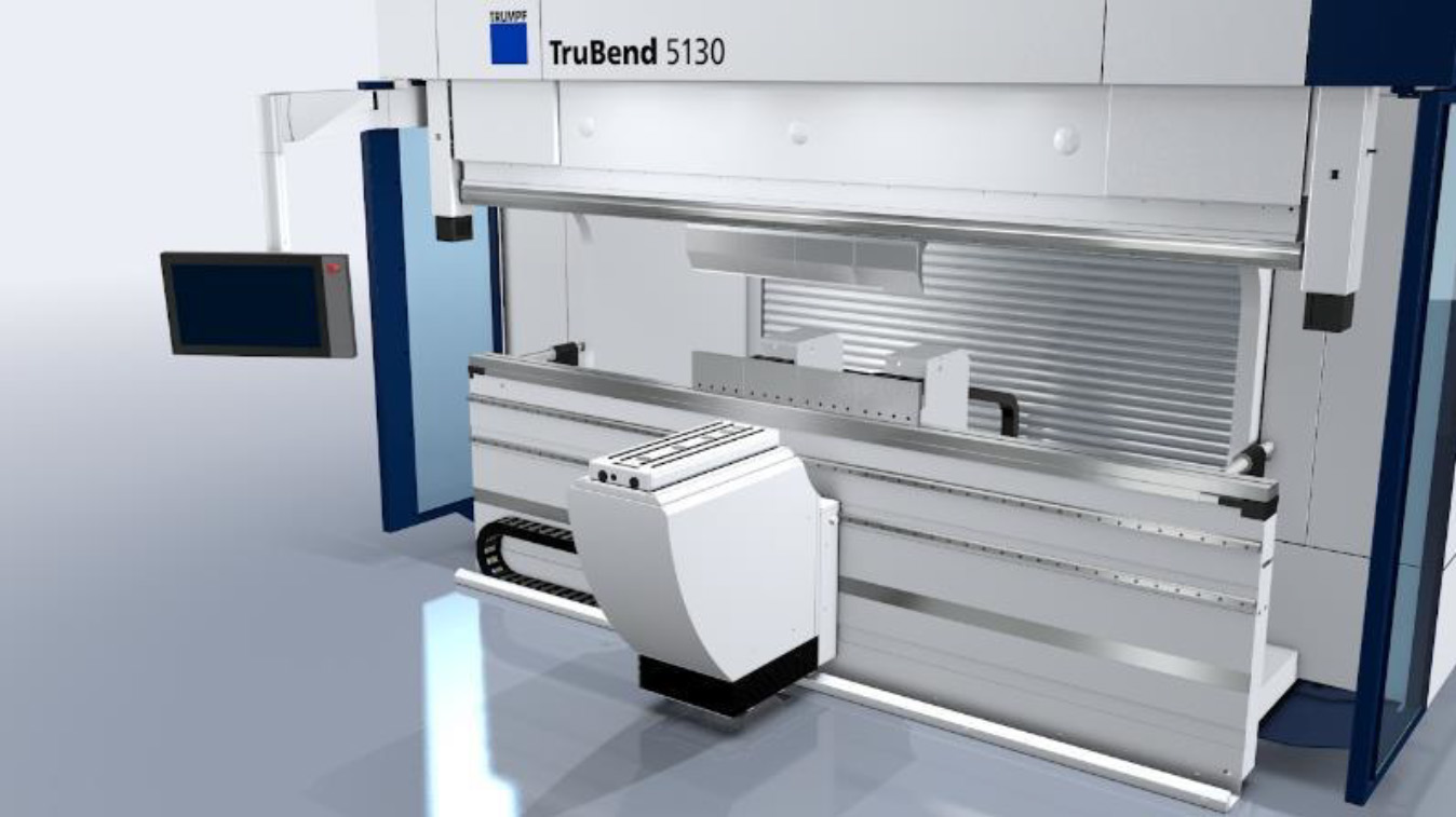

A look into the inner workings of the bending device: motor, encoder and sensor cables as well as an earth cable are guided in the e-chains from igus and supply the bending tool, which is completely manufactured at the Linz location. (Source: igus GmbH)

TruBend Series 5000 units are known as press brakes in the metals industry and have a bending tool for large or heavy parts upon which the sheets are processed and placed. The tool supports up to 30-degree angles and its height can be automatically adjusted. “For large and very heavy workpieces, this support is necessary to bend the sheets accurately, requiring only one operator,’’ says Volkmar Schmidt, head of technical purchasing at TRUMPF Maschinen Austria. The bending device can be moved freely from left to right.
These machines contain multiple cables that must follow long spans of machine motion. Left unguided, these cables could easily become tangled, not to mention wear out from repeatedly rubbing against each other and a machine’s surfaces. To prevent these potential problems, TRUMPF relies on energy chains from igus when the bending device is moved. igus, Cologne, Germany, operates its North American facilities in Providence, R.I.
For the Series 5000, TRUMPF uses R4.1L series chains from igus, which are enclosed tubes using overlapping lids instead of the standard crossbars. The lids can be opened at both ends and pivoted upwards by 115 deg., which cuts assembly time and cost. If necessary, they can be removed completely, fitted again, and closed by pressing downward.
