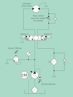

Conveyor Drive Overheating
Feb. 7, 2019
Try your luck at this month's brain teaser.
A simple conveyor transfers salvaged cast iron from an auto shredder to a large storage building. The shredding machine was recently overhauled, and one of the improvements resulted in being able to shred more cars per hour than before.
Operators sometimes had trouble getting the conveyor started when it was loaded. They discovered, though, that increasing the pump’s pressure setting solved the problem. However, hydraulic oil in the reservoir would overheat at times.
Plant personnel called a service technician to troubleshoot the overheating problem. He checked the case drain flows from the motor and pump and determined they were acceptable.
Any idea what the problem was?
