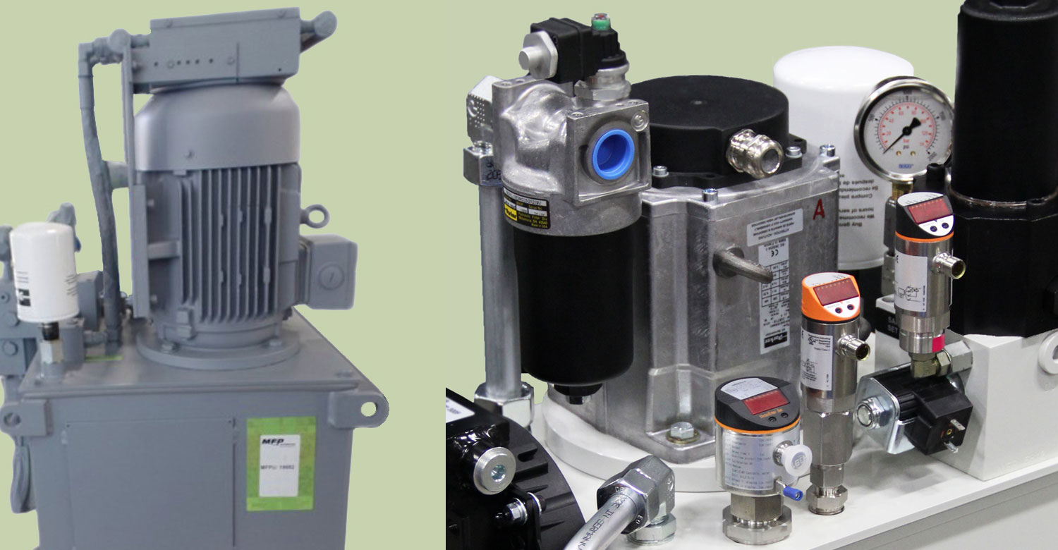

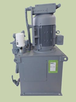

This conventional HPU not only consumes more energy than its VFD HPU counterpart but is also substantially larger—a 594-in.2
The new system replaces a conventional HPU consisting of a 5-hp induction motor, also driving a Parker PD018 piston pump and including a pilot-operated compensator with heat exchanger and an automotive-spec pressure and return filter. The conventional system also included an eight-station manifold assembly with seven Parker D03 directional valves, four Parker pilot-operated check modules, seven pressure-reducing valves, five flow controls, and a BSPP-ported steel manifold.
The new VFD-driven power unit provides better control over pump speed and dramatically reduces the package size above the tank lid. The VFD reduces operating cost by lowering the speed of the pump when it is in a steady-state condition. The variable-flow, pressure-compensated pump delivers only the flow needed when at pressure. Lower energy usage also reduces heat generation, allowing a footprint with a smaller tank to be used without affecting the machine performance. In addition, better control over speed and flow reduces manifold, resulting in fewer potential leak points and failure modes.
