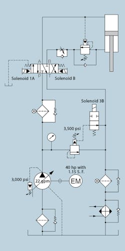

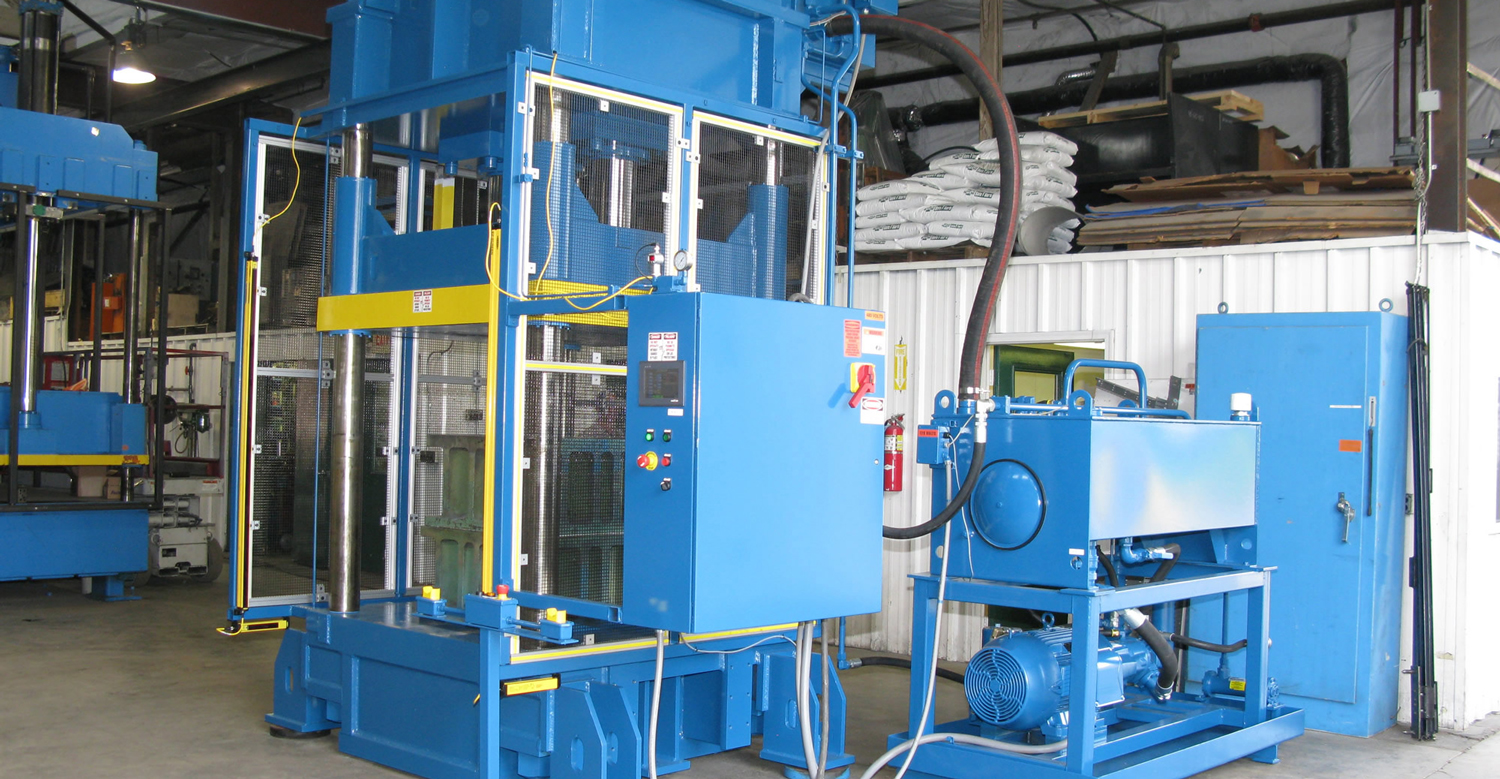

A press that had worked well for several years wouldn’t start. The electric motor would hum and buzz for a few seconds, then cause the overloads to trip. Maintenance people figured the electric motor “ran out of juice,” as they said, so they replaced it with the same size and brand. They felt that a 40-hp motor with a 1.15 service factor should deliver 46 hp with no problem when they calculated the flow and pressure requirements. However, when the new motor was installed, it did the same thing, stalling out.
When the system was turned on, solenoid 3B would be energized after 3 sec. This is a common technique to reduce the high inrush current demand of ac electric motors. Mechanics confirmed that 3 sec. occurred before solenoid 3B energized. They discovered that if they lowered the pump’s compensator pressure to 2,500 psi, the motor could start the HPU. Once it did, they then reset the compensator back to 3,000 psi. It would run continuously until they shut the system down and they would have to go through the same routine to get it started again.
Any idea what was happening?
