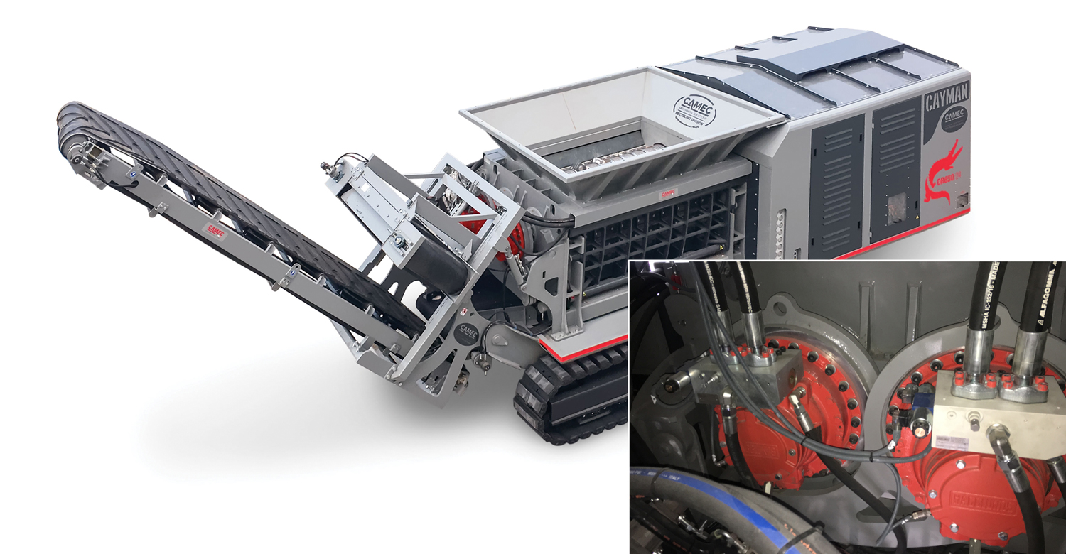

“We were intrigued to hear that such compact motors could offer the same performance as previous solutions, and without the need of a gearbox,” Lombardo adds. Camec asked Bosch Rexroth to rush-deliver a motor in time for the Ecomondo Green Technologies Expo and has since used Hägglunds low-speed,high-torque motors in a custom-designed 2-in-1 shredder solution.
Developed to recycle paper coils and other bulky waste, the shredder is equipped with two Hägglunds CA 140 motors on one side and two Hägglunds CA 210 motors on the other. These motors can work together for maximum power, but the option of freewheeling one of the motors in each set creates new flexibility. The CA 140 motors can transmit torque to 140 N-m/bar, and CA 210 motors can transmit up to 210 N-m/bar.
Both motors are rated for maximum speed to 310 rpm to provide low-speed output with no need for a speed reducer. When needed, the shredder can freewheel the motors to provide higher speed with lower power consumption. Lombardo adds, “After considering the alternatives, our technical department decided to use the motors because they require so much less space and do not need a gearbox.”
