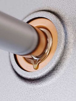

backup rings are critical to the performance of high-pressure aerospace hydraulic systems which power landing gears
Why Backup Rings are Critical to High-Pressure Aerospace Hydraulic Systems
March 18, 2024
Backup rings are small but important components which enhance the reliability and longevity of high-pressure aerospace hydraulic systems.
High-pressure aerospace hydraulic systems power everything from an aircraft's landing gear, flight controls, fuel systems and brakes. These intricate systems work harmoniously to ensure the aircraft's safe and efficient operation. Yet, they can't function optimally without a component that's often overlooked but undeniably crucial – the backup ring.
Despite their size, they play a critical role in ensuring the reliability and performance of high-pressure aerospace hydraulic systems. Backup rings help to ensure the integrity of seals used within these pressurized systems which leads to reduced leakage and a longer lifespan for components.
