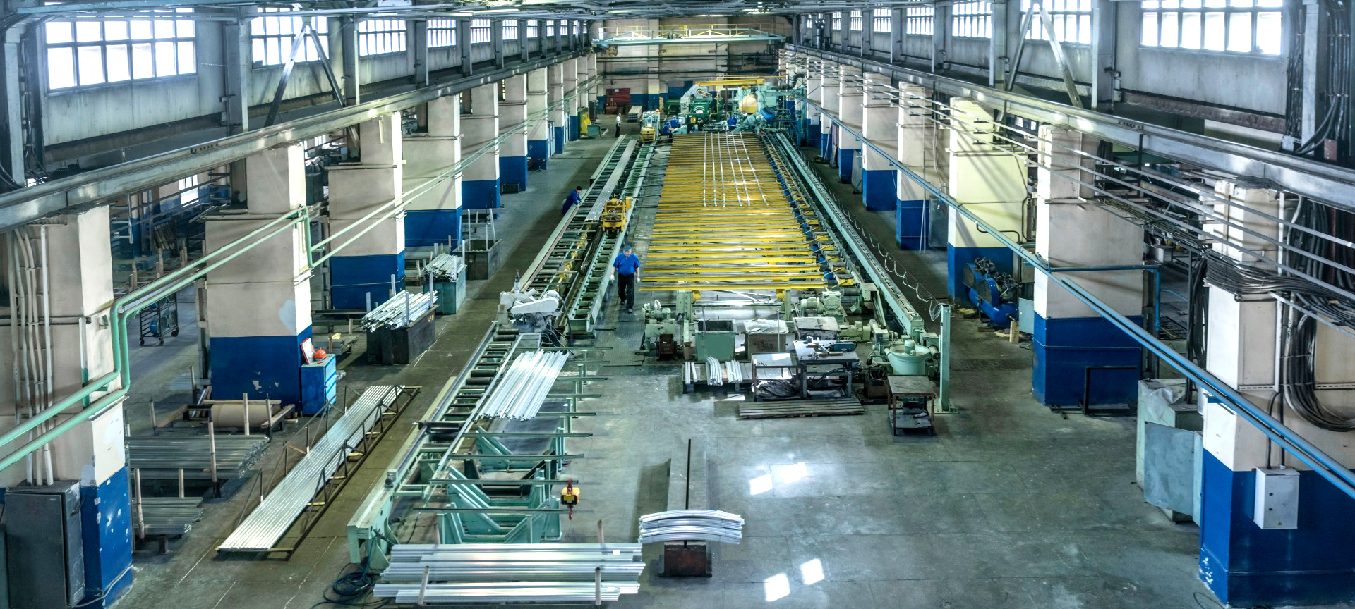

Extruded aluminum parts are some of the most valuable materials produced by heavy industry today. From simple extrusions for door and window frames to complex components using specialty aluminum for automotive and aerospace applications, the aluminum extrusion press has been, and still is, a powerful and productive manufacturing machine.
Today’s extrusion presses are, in most cases, hydraulically powered. Many of them have been running for decades. However, press owners and operators are often reluctant to invest in improving the hydraulics on their systems despite the significant — and constant — wear and tear on the machine. As a result, decades of extrusion parts production can take its toll on critical hydraulic components such as pumps, manifolds and control valves.

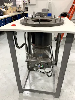

Proportional pump controls such as the Rexroth HS5 and HS5E feature a mechanical valve spool that has extremely high tolerances, which enables it to provide the hydraulic performance of a servo valve with only one moving part. In addition, the Rexroth proportional valves feature digital electronics that provide much faster and more precise response times so that the valve dynamics, and thus the response of the pumps, are much more efficient.
The Rexroth HS5 and HS5E support closed-loop swashplate control, pressure control and power control, enabling press operators to improve how they manage extrusion performance. The HS5 utilizes the Rexroth VT-HPC controller, located separately in a control cabinet, whereas the HS5E has the controller built into the valve, making installation much easier.
