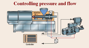

Figure 1. A P/Q controller controls hydraulic flow and pressure through a servovalve and ensures a smooth transition when operation changes from speed control to pressure control. S/V represents a speed transducer, and P/V symbolizes a ...
Figure 1. A P/Q controller controls hydraulic flow and pressure through a servovalve and ensures a smooth transition when operation changes from speed control to pressure control. S/V represents a speed transducer, and P/V symbolizes a pressure transducer. Not shown is a hydraulic motor that rotates an auger that feed plastic pellets into a melting/injection chamber. The motor drives the auger through the cylinder's hollow piston rod and is much smaller and lighter than an electric motor — another big benefit of hydraulics.

Injection molding operations demand high speed motion and tight pressure control. As shown in Figure 1, an electronic control sends a command to a proportional valve that controls flow and pressure to an injection cylinder. The valve initiates an injection by controlling flow into the right side of the cylinder. Flow controls speed of the cylinder's piston, which, in turn, controls flow of molten plastic into a die.
A linear displacement transducer differentiates changes in piston position with respect to time, creating a velocity signal that is routed to the machine control. Simultaneously, a pressure transducer monitors fluid pressure in the hydraulic line feeding the cylinder.
As plastic is injected into the die, load applied to the piston increases, which, in turn, increases hydraulic fluid pressure. Control software detects when a predetermined pressure is achieved through the pressure transducer. When this occurs, the control signals the valve to transition from a speed-control mode into a pressure-control mode. The valve then continues controlling flow to right side of the cylinder to maintain the preprogrammed pressure — even if the target pressure or the load changes.
A digital proportional valve with spools tailored to injection requirements makes the critical transition from speed control to pressure control smooth and precise, without allowing any sudden changes in pressure, as shown in Figure 2. An integral P/Q digital controller coupled with a remote pressure transducer performs the closed-loop control of pressure and flow during holding and counter pressure phases of injection. In commanding the proportional valve, the P/Q controller ensures a repeatable and independent transition.
