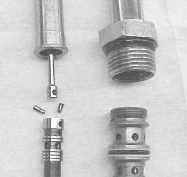

Figure 1. Roll pin failure of directional control valve. Click on image for larger view.
It's difficult to predict dynamic forces and impact loads on a valve that shifts in less than 50 ms. When testing valves at Eaton Hydraulics, we cycle valves repeatedly to simulate years of use. Computer modeling and engineering expertise are valuable, but nothing proves a design quite like a pounding endurance test.
When developing a new range of directional valves, we performed endurance tests on production prototypes and another company's valve. At full flow and pressure, loading snapped the roll pin holding both valves together in less than 250,000 cycles, Figure 1. As a result, our engineers switched to a stronger, solid steel dowel pin.

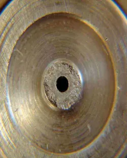

Because most valves have moving parts, we cycle components to ensure they will exhibit acceptable wear. Adhering to established standards are not enough when evaluating new materials or designs, We validate new designs through endurance testing. When we designed our new ERV3-10 proportional relief valves, endurance testing revealed a poor material and heat-treat selection for the relief valve seat, Figure 4. Detection of this failure resulted in an improved design, which would not have happened with only fatigue or burst testing. Endurance testing made the difference.
Endurance testing of of a prototype proportional relief valve revealed poor selection of material and heat treatment for its seat. Click on image for larger view.
