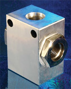

New 1SH36 in-line, ball-type shuttle valves exhibit high flow characteristics that minimize the response time of the components they feed. They sense higher pressure between two lines on a hydraulic circuit, allowing flow from higher pressure ...
New 1SH36 in-line, ball-type shuttle valves exhibit high flow characteristics that minimize the response time of the components they feed. They sense higher pressure between two lines on a hydraulic circuit, allowing flow from higher pressure line to flow through. They are designed for flows to 20 lpm and pressures to 210 bar. They weigh 190 g and offer maximum internal leakage around poppet of 0.6 ml/min. Pressure drop is 1 bar at 20 lpm.
