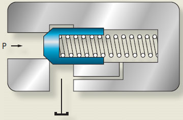

Direct acting — A direct-acting valve consists of a poppet or ball (poppet will be used for simplicity of discussion), held exposed to system pressure on one side and opposed by a spring of preset force on the other. In a fixed, non-adjustable, normally closed relief valve, Figure 1, the force exerted by the compression spring exceeds the force exerted by system pressure acting on the poppet. The spring holds the poppet tightly seated. A reservoir port on the spring side of the valve returns leakage fluid to tank.
Figure 1. Simple, direct-acting relief valve has no adjusting screw and, therefore, opens at a fixed, preset pressure as controlled by the force from a compression spring.
When system pressure exceeds the valve spring setting, the fluid unseats the poppet, allowing a controlled amount of fluid to bypass to the reservoir, maintaining system pressure at the valve setting. The spring re-seats the poppet when enough fluid is released for system pressure to drop below the valve spring setting.
