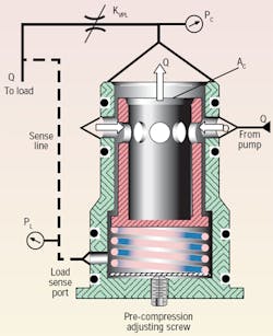

A pressure reducing, pressure compensated flow control valve is shown in a cartridge configuration in Figure 1. However, it is also manufactured in a conventional spool configuration. The operating principles are the same in both, it’s just the geometry and math models that differ somewhat. Figure 1 will also serve as a review, covering the function that was detailed in previous issues.
Figure 1. Cartridge configuration is the subject of this look at the pressure reducing, perssure compensated flow control valve.
Anatomy of the valve
A moveable spool is shown in cutaway in red crosshatch, and a stationary cartridge body is shown in cutaway in green zigzag. This figure shows how flow metering and control are accomplished with circular metering windows of the spool and how they change their alignment with the fixed, circular metering windows of the body.
The spool has a brim at the bottom whose ridge prevents a bias spring from pushing the spool out the top, or nose, of the cartridge body. The brim also forms a barrier that hydraulically isolates the spring cavity (load sense port) from the compensator outlet at its nose.
The effective pressure sensing area of the spool is formed by the nose of the spool, and, thus, the spool senses the differential pressure drop across the metering orifice, KVPL. The spool, at once, senses its own outlet pressure, PC, at the cartridge outlet, and the load pressure, PL, via the load sense port connected to the bias spring cavity. The interaction of the differential pressure and the spring causes the compensator to try to maintain a constant differential pressure across the metering orifice. Therefore, it maintains constant flow to the load with a given 4-way setting, even in the face of changing pressures. We shall see shortly that this is only approximately true.
The spool fits closely inside the cartridge bore but must move freely without binding. Circumferentially machined balancing grooves (not shown in Figure 1) prevent the binding that will accompany radial pressure unbalance. Smooth, stiction-free movement also requires roundness, straightness, and smooth finish of the spool and bore because the radial clearance between them is normally only a few ten thousandths of an inch. The small clearance ensures control of spool bypass leakage. As with all spool valves, some leakage occurs. However, the leakage is not going to be modeled in this study because a slight amount of it does not significantly affect the performance of the valve. Other factors, we shall see, are far more important.
Figure 1 also shows how fluid enters the cartridge radially and exits the nose axially, making its way to the 4-way metering land, KVPL, then to the load. The cartridge configuration allows dedicating one compensator to each of the several 4-way sections in the valve stack. As explained in previous editions of “Motion Control,” this design method helps isolate the operation of one function from others to minimize interactive effects of loads during simultaneous operations. At least that’s the intent; we’ll examine the actual outcome shortly.
