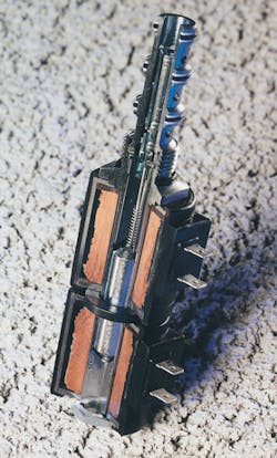

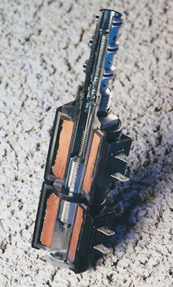

Cutaway of HydraForce Model SV10-47D 3-position, 4-way, double-coil solenoid valve (rated for 3500 psi, with 6-gpm flow capacity) shows coil S1 below S2.

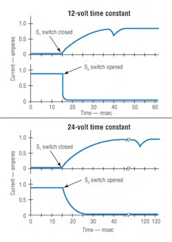

Time constants for 12- and 24-V systems are plotted above. (Click image to enlarge.)

The plots of the 12-V and 24-V time constants as the bottom coil is de-energized and the top coil is energized simultaneously indicate the problem. At 12 V, the current in the S2 coil dissipates in less than 4 ms. The dip or valley shown in the S1 characteristic indicates that the armature has moved completely to the S1-energized position. These characteristics should be typical of any on/off-type solenoid.
However, at 24 V, the current in S2 dissipates over approximately 16 ms because of the controller’s inductance. The current in S2 must fall below 100 mA before the return spring can overcome the magnetic force produced by residual magnetism and trickle voltage. At the same time, the top-coil current should not reach 500 mA before the armature begins to return to neutral. If it does, it will produce a force at the S2 end of the armature that will delay shifting. (This is true when the polarities of the two coils are connected identically.) When this occurs, the dip in the S1 characteristic appears 80 ms after the one recorded with the 12-V system. This delay caused the hesitation in the shifting of the transmission.
