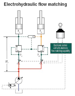

Electrohydraulic flow matching circuit shows an electrohydraulically controlled proportional pump supplying flow at the same time as the valve opens, improving response over loadsensing and flow sharing circuits.
Electrohydraulic flow matching (EFM) can improve machine hydraulics’ efficiency, stability, and dynamic response. EFM systems replace the pressure-controlled pump in HM-LS and HM-LUDV circuits with an electrically controlled, swivel-angleadjusted pump that supplies required flow at the same time the valve opens.
The following improvements result:
• The proportional pump modulates flow, letting excess pressure between pump and valve be set independent of the system’s maximum load pressure. In certain cases, EFM’s P is lower than the predetermined P for LS and LUDV systems, which saves energy.
• The pump in an EFM system does not operate as a pressure controller but as an electroproportional variable pump in an open control loop. Thus, the pump no longer responds to changes in load pressure and, instead, operates independently without interacting with the pressure compensators.
• The pump and valve are controlled almost synchronously. Therefore, EFM eliminates delays between joystick inputs and the LS signal arriving at the pump. This, in turn, improves system response, and it increases stability with respect to disturbance variables. That is, the working hydraulics are more agile and less susceptible to oscillations.
• Another benefit is that EFM can use well-established components, such as variable pumps with electrohydraulic load-sensing valves. Thus, development work is limited to functional interactions between components in specific applications.
