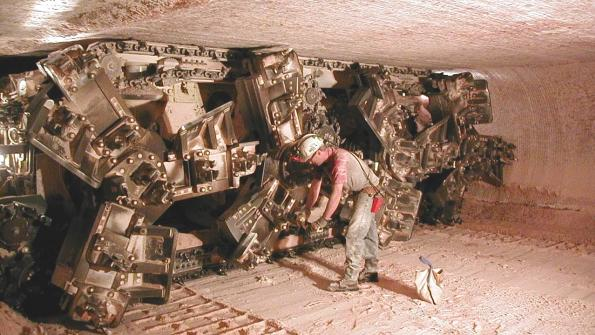

Work output in a potash mine requires machines with high mobility and reliability. Potash is a salt containing a high concentration of water-soluble potassium, so it is widely used in fertilizer. In response to the world’s increased demand for potash, Canada’s PotashCorp., Saskatoon, SK (PCS) stepped up production at its Rocanville, SK mining facility with an X CEL 44 continuous bore mining machine.
The X CEL 44 series miner, built by Prairie Machine & Parts Mfg., Ltd., Saskatoon, weighs in at 250 tons and can extract up to 1200 tons of potash per hr. The machine PCS had been using was propelled by a pair of fixed-speed hydraulic motors.  This was great when the machine had to plod along collecting potash. However, when it had finished mining one area, and had to move to the next work site, it moved at the same snail’s pace. This robbed productivity because the machine produced no output while it was in transit. Mine operators wanted to speed things up, so HyPower Systems Inc., Regina, SK, stepped in.
