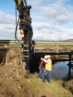

Attached to the boom of an excavator, the MD200 (200,000 Nm) 4-motor I-Drive is used for tasks including core barreling, screw anchoring, and foundation drilling. The compact I-Drive allows these operations to be performed in confined areas and close to existing structures.

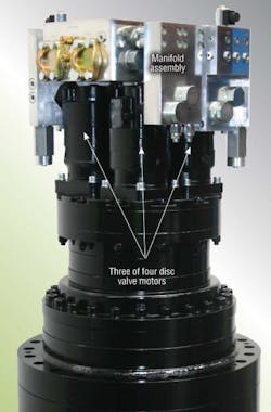

The Award-Winning Digga I-Drive power head uses four Eaton 6000 Series motors and a screw-in cartridge valve-based manifold. The compact I-Drive is more than 300% more productive than competitive systems. (Model UD300 shown with hood assembly removed to reveal the four motors and manifold system.)

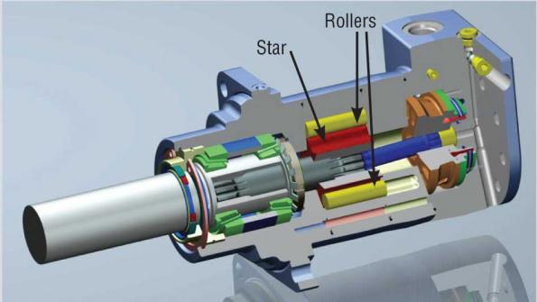

The compact 6000 Series motors use Eaton’s Geroler based design, whereby rolls seal the space between a rotating “star” and stationary gear ring. A rotary disc directs fluid into the void between the star and ring, causing the star to rotate and giving the motor its name.
Szota revealed, “This design accommodates high flow rates and high pressures while providing high starting and low-speed torque characteristics. The Geroler design is inherently more efficient than standard gerotor designs for two reasons. First, the rollers provide tighter sealing between the moving parts. Second, the rolling action creates less friction than the sliding motion of gerotor designs.”
Digga engineers also designed a screw-in cartridge valve manifold system to control flow to the I-drive four disc valve motors. The manifold simplifies operation by allowing the operator to selectively engage and disengage motors to provide variable speed and torque.

Ganapathy explained that Eaton’s Char-Lynn gerotor and Geroler motors have an inner rotor, called the “star,” and a non-concentric outer rotor. The star and the outer rotor have an unequal number of teeth. The volume of the spaces between the teeth of the two rotors changes continuously during each complete cycle. Pressurized fluid flows into a small cavity that expands into a larger space, creating torque on the shaft attached to the inner rotor as the rotors turn.
Eaton’s Char-Lynn motors are based on what its developer, Lynn Charlson, called the orbit principle — which gives them their high power density, modularity and economical design. The orbit principle describes the motion of the star in both gerotor and Geroler motors as it rotates inside the stationary outer rotor.
Geroler motors use a roller in the spaces between the rotors, whereas the two rotors contact each other in gerotor motors. Geroler motors are more efficient because the rolling friction between the rotors is less than the sliding friction between the rotors in a gerotor motor.
