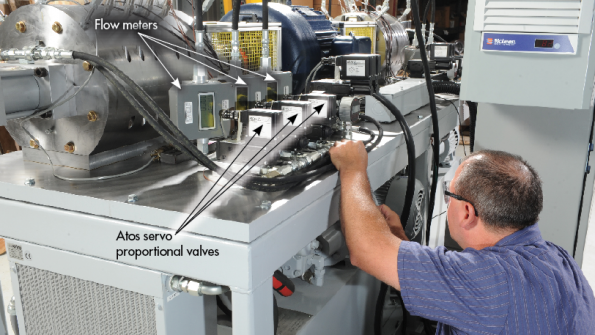

Callahan’s Gary Cotton explained, “This particular test rig has a double-shaft electric motor that provides enough power to test up to eight bearings at a time. Aside from the electric motor, which provides rotational power for testing, the rest of the test system relies on hydraulics. The bearing test rig consists of 10 proportional valves to control hydraulic fluid to two axial loading cylinders, two radial loading cylinders, and lubricant flow to the bearings undergoing load tests.”
Closed-loop force control
Cotton continued, “The machine’s main force control system consists of a variable-displacement, axial-piston pump with pressure compensation feeding four Atos DLHZO-TE-040-V11 servoproportional valves for controlling the cylinders that apply loads to the bearings undergoing testing. These valves have LVDT spool position feedback and on-board electronics. The valves can flow up to 1.3 gpm each at a 435 psi ∆P and are extremely quick, with response of less than 10 msec. The PLC and load cells originally used were much slower, thus creating an unacceptable overshoot when applying loads.”
To overcome these problems, an RMC 150E H2-DI/0 four-axis motion controller, from Delta Computer Systems, Battle ground, Wash., was specified to close the control loop on all force control axes. Cotton offered, “The motion controller has a pressure (force) control feature to process the feedback signals from load cells on the cylinders. The forces applied to the bearings are now typically held to less than 0.5%. One individual test was set at 33,000 lb of radial load and stayed within a ±45 lb range throughout the test cycle.
“An unforeseen snag in the retrofit  was that even with a pressure compensated pump, the force control system began overheating when operated at pressures greater than 2500 psi. A kidney loop (offline cooling and filtration circuit) was subsequently added to fix this problem.”
Cotton added, “The test stand has two additional power units run by low-pressure gear pumps. These circuits feed six Atos QVHZO-AE-06/12/PE pressure-compensated proportional flow control valves with controlled-temperature lubricant to the bearing specimens. These valves can be set individually to supply from 1.5 in.3/min to 3 gpm to the various bearing lube ports.” Flow meters in these lines generate feedback signals to the controller for continuous monitoring.
