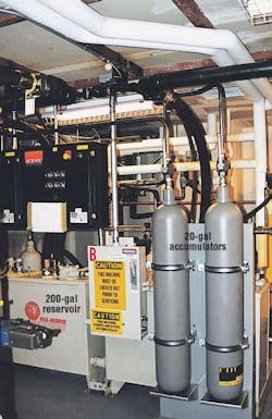

Ken Griffin, Technician at Star Trek: The Experience, Las Vegas Hilton, says this HPU has a 200-gal reservoir with an off-line filtration (kidney) loop. The kidney loop is driven by a 5-gpm gear pump piggybacked to the main pump. Fluid is routed through 3-µm filters and a 2½-gal heat exchanger for cooling. A pair of 20-gal accumulators provides supplemental flow for short-duration peak demand periods. A 25-hp electric motor running at 1800 rpm drives a main, axial-piston pump, which is pressure-compensated at 1500 psi to deliver up to 25 gpm. The pump is driven by a 25-hp electric motor running at 1800 rpm.

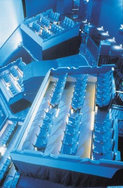

Participants in Race for Atlantis ride in six motion bases positioned in front of a spherical screen showing 3-D imagery and multi-channel sound. (Click on image for larger view.)
But that's not all. Multi-directional sound is generated by a 6-channel, 16-kW sound system, with an additional two channels transmitted by wireless Personal Sound Environment headsets worn by visitors. Another effect is provided by the world's largest water-based fog-generating system, which recovers and recycles the water to minimize consumption.

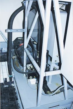

Each motion base provides six axes of motion through electrohydraulic cylinders controlled by servovalves and fitted with magnetostrictive linear displacement transducers for closed-loop position and motion control. As with the Star Trek attraction, motion bases have six cylinders arranged into a tripod configuration. In fact, motion bases for both the Atlantis and Star Trek attractions were designed and built by McFadden Systems, Santa Fe Springs, Calif.
Motion base undercarriage reveals accumulator that ensures a pair of cylinders has enough pressure and flow to perform the most demanding dynamics of ride sequences. Accumulators are also used for supplementing pump flow and as a standby emergency power source. (Click on image for larger view.)
Each cylinder is controlled by a servovalve mounted to it. This design configuration minimizes the amount of fluid between the servovalve and cylinder, which, in turn, maximizes system response by limiting fluid compliance between the servovalve and cylinder.
An accumulator serves each pair of cylinders to ensure that flow and pressure can be maintained by each cylinder. Accumulators also are relied upon by the hydraulic power unit (HPU) to store energy for peak flow demands. This allows using a smaller pump because the accumulators can be recharged during periods of low demand and release their stored energy when the system needs more flow than the pump can provide.
A third use of accumulators is for storing emergency power. Visitors board each motion base from a moveable loading/unloading platform. Before a ride sequence can begin, a pair of hydraulic cylinders pivots each loading platform out of the way. This prevents a collision from damaging the motion base or platform.
If, for example, an electrical power outage would occur, the HPU might not be able to power the cylinders into position to unload the motion bases. To prevent this from happening, hydraulic circuits for the platforms contain accumulators to store enough energy to fully actuate the cylinders, even if a complete electrical power outage occurs.
