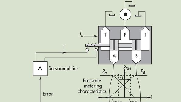

To understand the function of and need for integral control, you must understand the shortcomings and limitations of the proportional electrohydraulic positioning servomechanism. A simplified, combined cutaway and block diagram is shown in Figure 1.
Consider that no load force is on the cylinder, so fL = 0. If the cylinder is to be stopped, the rod-end pressure must exceed the cap-end pressure by the amount appropriate for the cylinder’s area ratio. Furthermore, there must be enough current into the valve’s solenoid coil to sustain holding pressures in the valve.
The holding current is identified in Figure 1 as IST, NL — the stall current under no-load conditions. Applying an external load causes the cap-end pressure to rise, and the metering characteristics of the valve demand that the rod-end pressure drops. The new equilibrium conditions are identified as IST, FL, standing for stall current under full load. Obviously, this requires a change in coil current by an amount indicated by ∆I.
Figure 1 — This simplified cutaway/block diagram shows how pressure metering in the valve combines with disturbances within the valve to generate cylinder positioning error. Click image for larger view.
The current results from the servoloop closure, and if the command signal, C, did not change, then the new current could result only from a change in the position transducer output, Vx. The output of the transducer changes only if the cylinder position changes. We conclude then, that the positional servomechanism — under this proportional control — cannot perfectly compensate for load changes, so it inherently produces a load-induced positioning error.
Disturbance forces, fD, which act on the valve spool, yield similar results. All disturbances can be resolved into disturbance currents that act on the valve input. Furthermore, once the loop is designed, and gains have been established, the disturbances can be resolved into output positioning errors. The details will not be revisited here, but Figure 2 summarizes them in schematic form.
Figure 2 — All disturbances can be resolved into a single disturbance current acting on the valve input current. Click on image for larger view.
The disturbance current can be caused by several conditions, such as supply and tank-pressure changes, variations in load force, and other conditions that affect valve null. Disturbance current is measurable, but the depiction in Figure 2 is somewhat a mathematical abstraction of the actual physical process. It is, nonetheless, useful and accurate enough for explaining the process.
