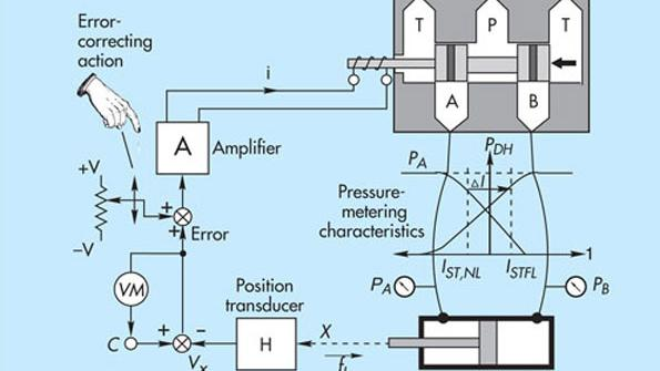

Figure 1 — A human observer monitoring error voltage can eliminate the steady-state positioning error caused by any disturbance.
The system shown in Figure 1 is the same one that appears in Figure 1 from last month, but a human observer armed with an error-correcting potentiometer and voltmeter has been added. Consider that when there was no load on the cylinder, the system was at null; that is, the error-reading voltmeter would indicate zero. This can be done in a real system by adjusting the null control on a servovalve while observing the voltmeter (labeled VM) and continuing to adjust until the voltmeter reads zero.
Next, imagine that the magnitude of the load increases. For reasons already explained, the cylinder moves to a new position, resulting in a load-induced positioning error. But, more importantly, a readable voltage appears on the voltmeter. That value, divided by the position transducer gain (labeled H), is the amount of the position error.
Human-error correction
If the human observer turns the error-correcting pot while watching the voltmeter, and continues adjusting until it reads zero, the cylinder must go back to its original unloaded position. The load-induced error has been corrected! And if this is done at every stopping point, and sufficient time exists, all disturbances can be compensated for. This is the essence of integral control, but this example used a human operator affecting the control. Humans are good at such things. For example, in controlling the speed of a car, if the driver notices that speed is too low or too high, he or she increases or decreases power to the engine until the desired speed is achieved. Without thinking, the driver eliminates the error and, thus, performs the integral function.
