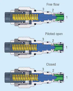

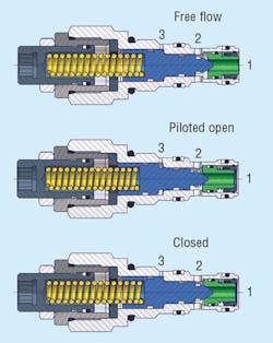

Cross-sectional views of a counterbalance valve show flow paths in each of its three operating states. Flow paths are established by pressure from ports 1, 2, and 3 acting on the pilot poppet (blue) and the check seat (green). (Click here for enlarged view.)
Advances in counterbalance valve technology are making controls easier and smoother. To reduce hysteresis in the counterbalance valve, all dynamic seals must be eliminated. Command Controls’ counterbalance valves have no dynamic seals, so they are virtually free of hysteresis. The valves are fast enough to follow any signal supplied to them, thus eliminating bounce, loud chatter, and high-pitch squealing. Their design has a high flow rating, which conserves energy, but remains controllable at very low flow. The valves also can serve as a full flow relief valve.
Away with dynamic seals
Because the pilot piston has no seals, a small amount of hydraulic fluid leaks past the pilot piston to purge the air from the pilot lines and provide warm oil to be circulated, making the valve very responsive. A small amount of leakage around the pilot piston has nothing to do with load-holding capability at the cylinder port. The best position for the valve to be mounted on the cylinder is with the valve’s adjusting screw pointing down, which allows fast air purging from the pilot line and the spring chamber. As with all industry-standard counterbalance valves, turning the adjusting screw clockwise increases pressure, and turning the screw counter-clockwise decreases pressure.
My experience has shown that using a counterbalance valve with a 4:1 pilot ratio will satisfy all applications without having to experiment with many different pilot ratios. Command Controls’ counterbalance valves are supplied with a built-in check valve for free reverse flow from port 2 to port 1. Other options include a sealed pilot piston for master/slave cylinder applications and a vented spring chamber to atmosphere (which makes port 2 insensitive to backpressure) for servovalve or regenerative circuits.
