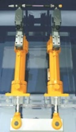

A system developed by Atos spa, Sesto Calende, Italy, uses digital electrohydraulic proportional valves, digital controls, and cylinders with position feedback in press brakes with bending capacities to 1000 tonnes that achieve positioning accuracy to 0.01 mm and downstroking speeds to 250 mm/sec.
To achieve this combination of high force, high speed, and high positioning accuracy, the system uses a master-slave control scheme executed through a pair of Atos digital electrohydraulic proportional valves. Each valve drives an Atos servocylinder, a hydraulic cylinder with electronic feedback of position. The valves themselves have a zero-lapped spool, which produces rapid response typically associated with electrohydraulic servovalves. Each valve's spool is driven by a single proportional solenoid, and spool position is monitored by an integral LVDT. The LVDT feedback provides closed-loop position control of the valve spool within the valve's integral electronics.
The master-slave control maintains parallelism by routing a control signal to one servocylinder, the master. Position feedback from the master cylinder is routed to the slave servocylinder, so instead of following the main command signal, the slave servocylinder uses position of the master cylinder as its target. This simplifies the control because the slave cylinder is used only to maintain parallelism.
