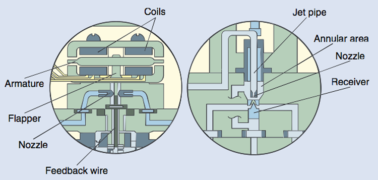

The term servo valve traditionally leads engineers to think of mechanical feedback valves, where a spring element (feedback wire) connects a torque motor to the main-stage spool. Spool displacement causes the wire to impart a torque onto the pilot-stage motor. The spool will hold position when torque from the feedback wire's deflection equals the torque from an electromagnetic field induced by the current through the motor coil. These two-stage valves contain a pilot stage or torque motor, and a main or second stage. Sometimes the main stage is referred to as the power stage. These valves can be separated primarily into two types, nozzle flapper and jet pipe, as seen in Figure 1 below.
The electromagnetic circuit of a nozzle flapper or jet pipe torque motor is essentially the same. The differences between the two lie in the hydraulic bridge design. A hydraulic bridge controls the pilot flow which, in turn, controls the main-stage spool movement. In a nozzle flapper, the torque produced on the armature by the magnetic field moves the flapper toward either nozzle depending on command-signal polarity. Flapper displacement induces a pressure imbalance on the spool ends which moves the spool. In a jet pipe, the armature movement deflects the jet pipe and asymmetrically imparts fluid between the spool ends through the jet receiver. This pressure imbalance remains until the feedback wire returns the jet pipe or flapper to neutral.
Historically, jet pipe and nozzle flapper servo valves have competed for similar applications that require high dynamics. Typically, better first-stage dynamics gives the nozzle flapper better overall response, whereas improved pressure recovery of the jet/receiver bridge design gives the jet pipe motors higher spool driving forces (chip-shearing capability).
Both valves require low command currents and therefore offer a large mechanical advantage. Motor current for these style valves is typically less than 50.0 mA. Note that these servo valves are also proportional valves, because spool displacement and flow are directly proportional to the input command.

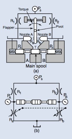

Viewing the principal internal parts of a flapper-nozzle servo valve, as shown in Figure 3 below, it should be clear that torque applied from a torque motor to the flapper arm, say in the clockwise direction, moves the flapper closer to nozzle A and tends to close it.
Concurrently, the flapper moves away from nozzle B to allow more flow through it, so the net result is a rise in pressure Pa and a drop in pressure Pb. The pressure difference, Pa - Pb is felt across the two ends of the main valve spool, driving it to the right and creating communication from port P to port B, and from port A to port T.

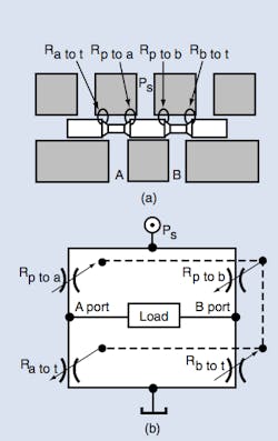

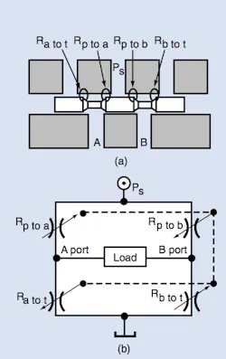

A 4-way directional control valve is represented in Figure 4. When the valve spool moves to the right, Rp to a and Rb to t open while Rp to b and Ra to t close. Fluid flows from the valve's A port to the load and returns via B port to tank. Left spool movement opens Rp to b and Ra to t so that fluid flows from the valve's B port to the load, returning to tank via A port.

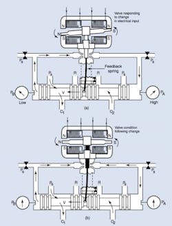

Torque motors, shown in Figure 5 below, are electromechanical rotary machines whose rotational travel is restricted often to less than one or two revolutions and are nearly always used for a piloting function. They are fitted with permanent magnets as the major flux source with the flux paths arranged to form a force bridge. Their limited rotation allows the armature to be mounted on a stiff flexure spring rather than bearings, although there is one known proprietary exception that uses a soft spring. The stiff spring and lack of bearings virtually eliminate hysteresis caused by bearing restriction.
Incoming current creates a second set of magnetic fluxes that unbalance the force bridge and results in net torque. The torque causes angular rotation until the flux-induced torque equals the counter-torque of the flexing spring plus any external load. An important characteristic of the torque motor is that the direction of rotation is affected by the direction of current through the coil. The electromagnetic field caused by the current is compared to the field of the permanent magnet in the magnetic bridge circuit and rotation ensues in a commensurate direction.
In the final valve assembly, the torque-motor armature is connected to a flapper sitting between two opposed nozzles, a jet pipe, or a swinging wand or blade. These last two steer a fluid stream, shown below in Figure 6, branch B. Basic operating principles and conceptual construction of flapper-nozzle and jet pipe servo valves are indicated in Figures 7 and 8 below, respectively. Torque motors almost exclusively pilot servo valves, and usually require less than 1W of power to fully operate although that is not a hard-and-fast rule.
Torque from the torque motor of a jet pipe servo valve steers the jet to one receiver or the other, unbalancing spool end pressures. Movement of the main spool continues until the feedback spring between the main spool and jet forces the jet pipe back to near null. Main spool position then is commensurate with coil current.
The flapper nozzle has two different implementations: the one already mentioned is the stiff design, wherein the force due to the impinging nozzle flow is small in comparison to spring and torque motor forces. In soft designs, the torque motor and nozzles are deliberately sized so that nozzle effluent causes a significant force on the flapper. One argument concludes that this design is more tolerant of certain contamination problems. The argument goes like this: when the two fixed orifices are open fully and unclogged, the unpowered flapper will center due to a combination of fluid-momentum force acting on the flapper, restoring force on the light spring, and magnetic force in the torque motor.
Should one of the nozzles or fixed orifices become partially blocked, reduced effluent flow produces less force on the blocked side of the flapper. The flapper then moves toward the clogged bridge leg until reduced force from the opposite receding nozzle equals the diminished flow force from the partially blocked nozzle. Current input to the torque motor then causes the flapper to move about a shifted neutral, but the pressure does not go to a hard-over level. The main spool might not shift fully in one direction, however.

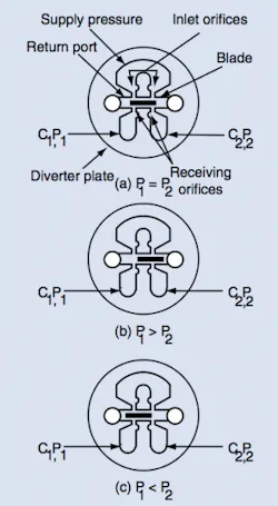

The swinging wand, as seen in Figure 6 above path D, has a mechanical-to-hydraulic interface that is proprietary. The versions of this interface include:
  • dual nozzle where the two fluid streams are deflected off the outside edges of the wand, and
  • single nozzle, where a single fluid stream passes through a central hole in the wand.
Consider the dual-nozzle version, shown below in Figure 9. The two fluid streams issuing from the source side of the pilot head are collected in opposing receiving ports. When a current into the torque motor causes the wand to swing, one receiving port experiences a rise in pressure while the other experiences a pressure reduction. As in the case of the jet pipe and flapper nozzle pilots, the resulting difference in pressure shifts the valve's main spool.
The single-nozzle version has a hole laterally bored and centrally located in the wand such that the single fluid stream issuing from the single nozzle must pass through the hole. When the wand is centered, equal pressures are collected in the two receiving ports. A current into the coil causes the wand to shift and the fluid stream is deflected off the inside edge of the central hole resulting in different pressures being collected in the two receivers. The resulting differential pressure between the two receiving ports shifts the main spool.
This swinging-wand design has a supply pressure limitation in that the pilot head must be sized for a particular supply-pressure range. If flow issuing from the nozzle(s) is excessive, fluid momentum force acting on the wand can pin it against the receiver side, locking it there. Installing an orifice matched with the supply pressure and the needs of the pilot stage in series with the nozzle side, remedies this problem. An approximately 2:1 change in supply pressure is possible with a single orifice.
