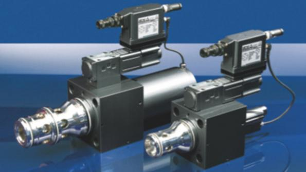

The cartridge valves’ main poppet slides in a sleeve and is hydraulically operated in closed loop through a servoproportional pilot valve on its cover. Integral digital electronics perform double position closed loop control of the poppet and of the pilot spool through integral LVDT transducers.
Key to the high speed of the machine is the high flow capability of the valves — up to 10,000 lpm — coupled with their quick response of 15 to 30 msec from fully open to fully closed. They are available in ISO 7368 sizes 16 to 100.

Valve C’s pilot valve has a single proportional solenoid with spool sliding in a sleeve to improve positioning accuracy and response. Its performance approaches that of a servovalve, but with the durability of a proportional valve.

High acceleration of high-inertial masses during the injection phase are inherent to large die casting operations. These can cause high mechanical shock (up to 50 G), which can compromise the operation of proportional valves. However, Atos designed the proportional valves to withstand these conditions by incorporating structural reinforcement of the most critical components, such as LVDT position transducers and onboard electronics. In addition, a shock absorber plate fitted between the valve’s driver shell and transducer housing reduces vibrations transmitted to the to electronics by about 10 times.
