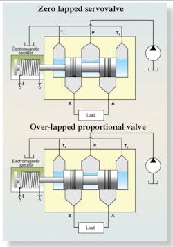

Q: I’m confused about servo and proportional valves because the differences don’t seem clear cut. What, exactly, is the difference between a servo and proportional valve?
A: The generic descriptive term that applies to this class of valves is, “continuously variable, electrically modulated, hydraulic directional control valves.” Germans use the term stetigventil — a continuously differentiable valve, and servo valves and proportional valves fall within this generic valve type. Unfortunately, we have no single word in English to cover these valves. The generic term should be “proportional valve,” with two subcategories: servo valves and proportional valves.

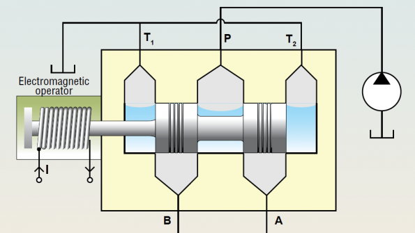

The illustration to the right represents a zero-lapped (servo) valve, where even the most minute movement of the spool opens flow paths. The lower drawing in the illustration represents a proportional valve, which exhibits 3% or more overlap between the spool and valve lands.
An extensive research project at the Fluid Power Institute was conducted to determine how a user could distinguish between a hydraulic proportional valve and a servo valve. We used electronic enhancements to determine the extent to which a proportional valve could be made to perform like a servo valve. Performance characteristics and construction and manufacturing methods were examined. The most significant discriminator was the amount of center overlap. We eventually defined a servo valve as one with less than 3% of center overlap, whereas a proportional valve has center overlap of 3% or more.

Q: What is a valve overlap?
A: Valve lap, or valve overlap, refers to the amount of spool travel from the center position required to start opening between the powered input port and the work (output) port or the tank port.
A zero lapped valve is one in which any tiny, differentially small amount of spool shift, either way, starts the opening. However, there is no contact between the O.D. of the spool and I.D. of the bore. And even zero lapped valves have some slight amount of overlap. Nonetheless, the zero-lapped term persists.

Q: Why is valve overlap the single most important discriminator between servo and proportional valves?
A: Simply put, the Fluid Power Institute study designated servo valves as having near-zero overlap and proportional valves as having significant overlap. Therefore, a so-called zero-lapped valve can be given servo valve status and still accommodate normal manufacturing tolerances because it allows up to 3% overlap. Furthermore, you can rarely distinguish any system performance degradation caused by that slight amount of overlap. In fact, some amount of overlap is desirable because it reduces the amount of spool-to-bore leakage.
Whenever performance specifications contain requirements of a specific accuracy, a hydraulic servo valve is probably going to be required. For example, a user may have a requirement that a cylinder must have total travel of 24 in. while propelling a 10,000-lb. load at a speed of 15 in./sec, and must achieve a final position with an error not to exceed 0.020 in. This kind of performance specification begs for a servovalve and motion control design methodology.
The most accurate systems are called null-seeking. What this means is that when the controlled output — say, the position of a cylinder — is in the desired position, the valve spool is near its center position. To achieve great accuracy in positioning, any small disturbance of the cylinder’s position (caused, for example, by a change in external load) must be immediately counteracted by a commensurately small move in the spool to overcome the disturbance. Such null-seeking operation is also required in many pressure control systems.
Zero lap in the valve means it can react and do its correcting job regardless of the direction of the disturbance and no matter how small it may be. Again, the term zero-lapped is an idealized term; the real valve will likely have a slight amount of overlap.
