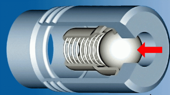

Perhaps the simplest of all directional-control valves is the check valve, a specific type of digital valve. Basic check valves allow fluid to flow in one direction, but prevent fluid from flowing in the opposite direction. As with all fluid power components, directional-control valves can be represented by standard symbols published in ISO 1219-2:2012. Figure 1 shows a cross-section of a spring-loaded check valve and its ISO 1219-2 representation.
Figure 1. Basic check valve allows fluid to flow in one direction. Shown are ISO symbol and cross-sectional photo of spring-loaded check valve. The spring keeps fluid from flowing unless downstream pressure acting on the poppet overcomes spring force.

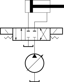

A 4-port, 3-position spool valve serves as a convenient illustration, Figure 2. One port receives pressurized fluid from the pump, and one routes fluid back to the reservoir (or to the atmosphere or exhaust muffler in a pneumatic systems). The other two ports are generally referred to as work ports and route fluid to or from the actuator. In this case, one work port routes fluid to or from the rod end of the cylinder, the other routes fluid to or from the cap end.
Figure 2. Shown is a simple circuit to control cylinder extension and retraction using a 4-port, 3-position spool valve. Hydraulic and pneumatic circuits should include a relief valve to prevent equipment damage or personal injury if pressure rises to a dangerous level. (For simplicity, the relief valve is not shown in this circuit.)
The valve represented in Figure 2 can be shifted to any of three discrete positions. As shown, in the neutral position, all ports are blocked, so no fluid will flow. Shifting the valve to the right routes fluid from the pump to the rod end of the cylinder, causing its piston rod to retract. As the piston rod retracts, fluid from the cylinder’s cap end flows to the reservoir. Shifting the valve to the left routes fluid from the pump to the cap end of the cylinder, causing the piston rod to extend. As this occurs, fluid from the rod end of the cylinder flows to the reservoir. Returning the valve spool to the center position again blocks all flow. (In reality, a relief valve would be provided between the pump and directional valve. It is omitted here for simplicity.)
