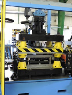

1. One segment of the metal stud manufacturing line engineered by TEKFAB is the slot press. In the press, hydraulic punches make two slot holes at a time, while the sheet steel passes through at about 200 ft/min.
This is the rationale that drove Albany, Ore.-based TEKFAB Inc., integrator of high-performance production lines, to use proportional valves and a programmable motion controller in a new line it developed for a manufacturer of steel building studs, Figure 1. Before roll-forming the edges of flat stock to make the legs of the studs, access holes are punched in the material using a compound die that first punches the hole and then forms the edges of the hole for strength—all during a single stroke.
Equipment used previously by the customer made the access holes via hydraulic rams operated by discrete directional-control valves. The gauge of the steel needed to be thick enough so that it wouldn’t tear radially to the desired cut outline when punched by the ram. Also, the speed of the punch was restrained to minimize any possible damage to the machine caused by the shock and vibration of the punching operation.
For the new stud production line, TEKFAB was given the task of speeding up the process, significantly expanding its automation capabilities, and making it more precise and repeatable. On top of that, the company had to deal with lighter-gauge steel than the traditional steel that was formed. “To meet these requirements, we knew that we needed to use an electronic motion controller,” said Rob Taylor, TEKFAB principal.

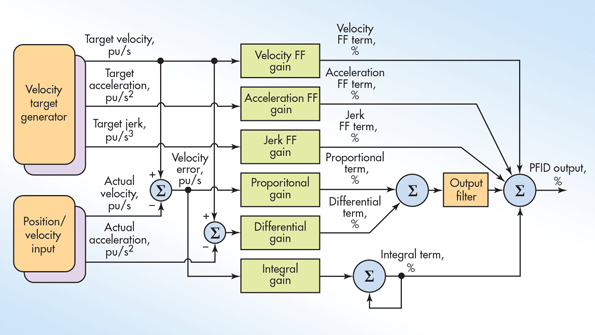

Closed-loop control compares actuator position information from a feedback device to a desired position, and the motion controller acts to eliminate this difference, which is called the error. The greater the error, the greater the output must be to correct the error. Gain parameters incorporated into the control-loop equation control the speed of the controller’s response. Therefore, a higher gain means a quicker response.
Setting a gain value too high, however, can cause the system to respond too quickly, and the motion may overshoot its intended position. Or a damping term may become too strong, causing the motion to stop short of the target. Setting the gains to be just right is the goal of the control loop tuning process.
Higher-end controllers augment proportional (P) gain with integral (I) and derivative (D) gain terms, which respond respectively to reduce errors that would build over time, or to errors that would build very quickly. Some controllers employ predictive elements in the control-loop equation called feed forwards. These act to reduce errors that are assumed to occur in the future.
3. This is a typical feedback loop, replete with P, I, and D terms and feedforwards for velocity, acceleration and jerk. The position/velocity input comes from a position transducer, such as the linear magnetostrictive displacement transducer used in the TEKFAB application.
Figure 3 shows the typical control-loop structure for position control (using P, I, and D) and feed forwards for velocity, acceleration, and, if needed, jerk (change in acceleration). The control-loop calculation is updated in real time, so subtle variations in the environment and the reaction of motion components are also dealt with in real time. The more precise the feedback information, the more precise the motion commands sent to the proportional valve, which causes the motion.
The combination of PID, feed forwards, consistent continuous feedback, and a servo or servo-quality proportional valve allows the controller to cause the motion to go to positions via user-programmable velocities, accelerations, and decelerations. The programmable accelerations and decelerations help reduce the wear and tear on the hydraulics and the mechanical systems. In the case of presses, one can ramp down the velocity so that when the tooling hits the work piece, the press will have just the right amount of kinetic energy to do the necessary work—without causing excessive shock or vibration.
