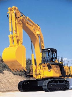

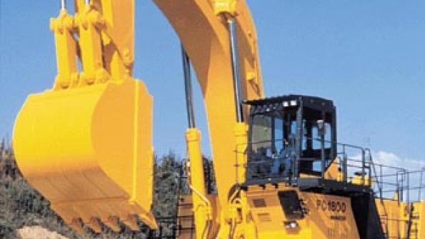

Komatsu's PC1800-6 excavator features three modes of operation, a load-sensing hydraulic system, and self-contained diagnostics.
To many people, the image of an excavator and a mining operation are nearly inseparable. Seeing the powerful arm of the excavator scoop up hunks of dirt the size of SUVs can turn even grown men and women into little more than gaping children, amazed by the size and power of these machines.
Komatsu Mining Systems, Inc., Vernon Hills, Ill., recently introduced its latest model of excavator, the PC1800-6 — a machine that is sure to turn a few heads. While bystanders certainly will be impressed by its sheer size, operators, too, stand to be impressed by its range of improvements, including higher horsepower, greater comfort, and larger bucket capacities.
The PC1800-6 features a 15.7-yd3 bucket, and incorporates two Komatsu Saa6D140E-2 engines with a combined output of 908 hp, as well as an advanced load-sensing hydraulic system. The result is high digging forces and fast cycle times.
Komatsu designed the PC1800-6 with operator comfort in mind. The operator's compartment is ergonomically designed to reduce fatigue and maintain high productivity. Operators are treated to a fully adjustable suspension seat and independently adjustable fingertip joystick controls, in addition to a climate control system with two independent air-conditioning units.
Hydraulics at work
Three working modes are used on the PC1800-6, enabling the operator to tailor the equipment's performance to the working conditions. A unique two-mode boom selector allows for choosing between smooth and power operations. Selecting the third mode, heavy-lift, provides a 7% additional boom lifting force for the most demanding lifting jobs.
Operation of the implements is accomplished primarily through two joysticks - the left controls the swing and stick (arm), and the right controls the boom and bucket. Flipping an on/off switch on the control panel engages the shockless boom control, which dampens the vibrating effect of the boom, through an inline check return valve. This feature has been shown to greatly reduce operator fatigue, as well as reduce spillage from the bucket.
The PC1800-6's hydraulic system features four of Komatsu's variable-displacement axial-piston hydraulic pumps for all implement and travel functions. Each has a maximum flow output of 111 gpm. The swing circuit is a totally independent circuit, using two Komatsu HPV 160 variable-displacement axial-piston pumps, with a maximum output of 83 gpm each.
Komatsu's Open Center Load Sensing System reduces hydraulic losses during operation and improves the machine's maneuverability by controlling the pumps' swashplate angle and matching the engine's performance to the pumps. The pump absorption torque can be set to DH, H, or G modes. These modes are defined as follows: DH mode (100%) is for heavy work, where large production is needed, along with maximum engine power. H mode (95%) is for normal digging and loading operations. G mode (83%) is for light-duty work, such as leveling and finishing operations.
The hydraulic system was specifically designed to deal with the brutal conditions found at most mining sites. Each main hydraulic pump diverts flow to its own dedicated high-pressure in-line filter. The hydraulic cylinders all incorporate metal guard rings to reduce contamination and contribute to a cleaner system.
The hydraulic oil return filters include a new hybrid element, developed by Komatsu, which increases the element replacement interval from 250 to 500 hr, and extends the hydraulic oil replacement interval from 2000 to 5000 hr. The element has a special construction, in which 25% of the circumference is constructed of a high-performance glass media, and the remainder is a dense paper gradient media. As a result, small particles are captured throughout the glass media, allowing greater life for the paper media.
To make troubleshooting easier, the excavators also feature Komatsu's Vital Health Signs Monitoring System (VHMS). VHMS monitors and logs the chassis condition, operating ability, faults, and any maintenance that has been performed. Data is stored in a controller, and can be downloaded to a PC. Within minutes, a service technician can access pressures, speeds, or temperatures. The system also gives the ability to read real-time hydraulic pressures without hooking up gages. In addition, VHMS notifies the operator when maintenance is due.
Better design
The PC1800-6 was so well-engineered that its hydraulic system runs 11% cooler than its predecessor, and one user described it as "so big, but you can control it as if it were a small excavator working on a tight jobsite." And perhaps that's a good measure of a well-engineered product - making the behemoths as easy to operate as the little guys.
