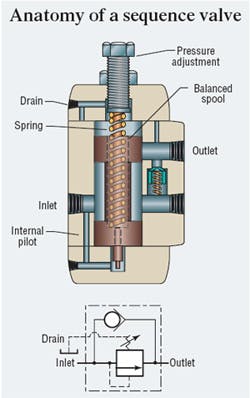

Figure 1. Simplified cutaway of a typical hydraulic sequence valve, top, and its schematic symbol, above.
When two or more cylinders operating in a parallel circuit must move in sequence, the only positive way to do this is with separate directional control valves and limit switches or limit valves. This setup ensures the first cylinder reaches a positive location before the second one begins to move. When safety or product quality will not be compromized if the first cylinder does not complete its cycle before the second one starts, a sequence valve can be a simple way of controlling cylinder actuation.
Figure 1 shows a cutaway of a typical sequence valve and its schematic symbol. Most hydraulic sequence valves must be used in series with a directional control valve, and a preset pressure must be reached before the valve allows fluid to pass or change flow paths. The sequence valve shown is a direct-acting, internally piloted design offered by many manufacturers. This valve can be changed in the field to externally piloted when required. When this is done, the valve’s part number should be changed to indicate the conversion. Several manufacturers also offer pilot-operated sequence valves. Pilot-operated sequence valves stay closed to within 50 psi or less of set pressure. Direct-acting sequence valves may partially open at 100-150 psi below set pressure, which could allow premature cylinder creep.

Fluid at the sequence valve’s inlet is blocked by a balanced spool, which is held in place by adjustable force from a spring. When force from fluid pressure at the inlet exceeds the spring force setting, pressure pushes the spool up, routing fluid to the outlet to keep pressure from increasing. Pressure at the inlet never drops below set pressure when there is flow to the outlet. When outlet pressure exceeds set pressure, the valve opens fully and pressure at both ports equalizes. A sequence valve must always have an external drain, and the drain port must be at no pressure or constant pressure because any pressure in this line adds to the spring setting.
A bypass check valve allows reverse flow when the valve is used in a line with bidirectional flow. In some applications a sequence valve may be externally piloted from another operation.

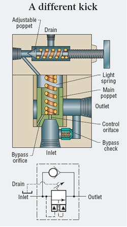

Figure 3. Cutaway shows internal workings of kick-down sequence valve, top, with schematic symbol shown below it.

Figure 3 shows a cutaway view of a typical kick-down sequence valve, with a schematic representation below it. Pressurized fluid at the inlet flows up to a main poppet, through a control orifice, and to an adjustable poppet, which is held closed by spring force. Pressure tends to push the main poppet up (open), but equal pressure and a light spring on the opposite side holds it shut.
Figure 4. Hydraulic circuit operates similar to that of Figure 3, but kick-down sequence valves offer substantial energy savings.
When pressure builds enough to open the adjustable poppet, flow starts passing through it faster than it goes through the control orifice. This creates a pressure imbalance, so the main poppet rises. When the main poppet rises high enough to route trapped fluid through a bypass orifice, hydraulic pressure above the main poppet drops because the bypass orifice is larger than the control orifice. At this point the only force holding the main poppet shut is spring force and backpressure at the outlet port. When flow stops, spring force closes the main poppet because pressure has equalized.
The circuit in Figure 4 is the same as in Figure 2, except it is uses kickdown sequence valves instead of standard sequence valves. Cylinder 2 will not move forward in this circuit until pressure on Cylinder 1 has reached 750 psi. When a kick-down sequence valve opens at its pressure setting, it allows fluid to pass at 50 psi plus whatever it takes to overcome resistance after it.
This means the whole circuit from the pump to all actuators is 50 psi plus Cylinder 2 resistance. The pilotoperated check valve at Cylinder 1’s cap-end port keeps it pressurized and at near full force while Cylinder 2 extends at low force. Energy waste is low, so heat buildup is minimal.
