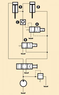

Replenishing
One of the considerations in synchronizing cylinders is leakage replacement. Under normal pressure, leakage can be practically zero over one stroke. Accumulated error is the main concern. A replenishing circuit, which replaces leakage after each cylinder stroke, eliminates this trend. In the circuit, the cylinders are connected in series and controlled by the 4-way manual valve. The cylinders actuate limit switches, which control valves A and B. On the return stroke, if cylinder 1 bottoms first, valve A is actuated to open valve C, permitting excess fluid from cylinder 2 to flow to tank. If cylinder 2's piston returns first, valve B is actuated to direct fluid to retract cylinder 1.
