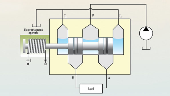

Pressure gain is a servo or proportional valve characteristic that is often misunderstood by those who have not had specific training in servo and proportional technology. The misunderstanding comes from the conventional explanation of valve and output actuator interaction, which usually goes something like this: The operator centers the valve, which cuts off flow and causes the actuator to stop. Technically, this is not true. In fact, it’s more the opposite that is the case: the actuator stops, causing the flow to stop. This becomes an important distinction when dealing with servo and proportional valves and is absolutely vital in understanding the implications if feedback control is used. It is less important in manually controlled systems.
Moving on, Figure 5 shows the pressure metering curves for a low overlap (not more than about 4% or 5%) proportional valve. All the pressure metering in this valve takes place with only about 7% or 8% of rated current. Assuming a linear relationship exists between current and spool position, the pressure metering range would be the same. A good general rule is that pressure metering takes place in the overlap zone of spool travel, plus about 4% to 5%. Thus, a proportional valve with 22% overlap will meter pressure over about 27% of spool travel. A critically lapped servovalve will meter the pressure over about the center 4% or 5% of spool travel or input current. For all spool positions or input currents in excess of that, the work ports will either be at supply pressure or at zero (actually, at tank port) pressure.
Figure 5 shows both the per-port and the differential pressure metering curves. The differential pressure metering curve is merely the mathematical difference between the two work port pressures, or, it could be collected directly if the valve is tested with a differential pressure transducer connected between the two work ports.
Pressure metering is a simple test procedure. However, referring to the overlapped valve of Figure 6, imagine removing the load from the work ports and connecting a pressure gauge in each work port. This means there will be no output flow during the test, even when the valve is shifted. Now imagine that the valve is fully shifted to route fluid out the A port (spool fully left).
What pressures would you expect to see on the two gauges? Of course, the A-port pressure would be at the supply pressure, and the B port pressure would be at or nearly zero. What would happen if the spool was to be shifted fully to the right? The pressure would be just the opposite, with the A-port low and the B port high. If the pressures changed, then some region of transition must exist somewhere in between. That region is at the center of the spool travel — that is, in the null zone of the valve. To collect the metering data, you need to slowly move the spool through the null zone and record the results as depicted in Figure 5. The greater the overlap, the wider the spread of the pressure metering zone.
Referring back to Figure 5, note that the control axis is valve input current, (control current), and the point where the two port pressures cross does not occur at zero current, but, rather, at a slightly negative value of about –0.5%. The drawing was made that way deliberately to make a point. This tells us that the valve is not nulled. The nulling procedure requires that the point of equal port pressures (zero differential pressure) coincides with zero current.
