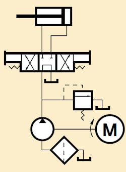

Open-center system
When the open-center system is in neutral, pump output flows through the directional control valve to tank. When this simple circuit handles only low flows and the directional valve spool has tapered lands, it proves to be very efficient. If several cylinders are used, the valve can be connected in series — that is, the tank port of one valve is connected to the pressure port of the next.

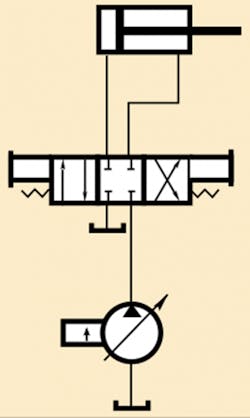

Pressure-compensated pump — A pressure-compensated, variable-volume pump is controlled by system pressure. As pressure increases, displacement of the pump decreases so that pump output at the preset pressure is only sufficient to make up for leakage. Used with a closed-center valve, the pump is stroked to minimum (zero) displacement when the valve is centered.
