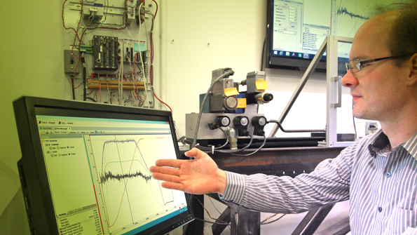

Author Jacob Paso shows motion profiles of various electrohydraulic proportional valves undergoing testing at Delta Computer Systems.
