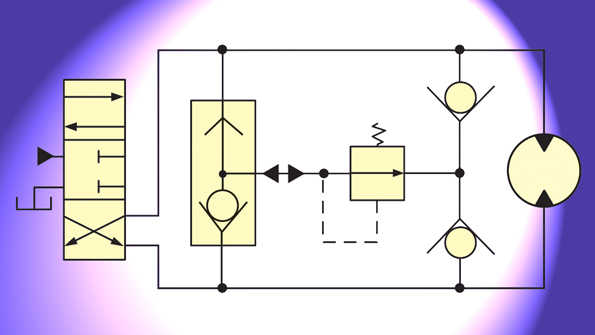

Fluid motor crossover—The shuttle valve in the brake and crossover circuit shown above separates the high- and low-pressure circuit branches and directs fluid to the relief valve. Here, the shuttle valve replaces back-to back check valves.
