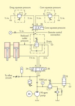

After reprogramming the PLC and replacing the accumulator bladder, a sand mold squeezing press still had the problem of the squeeze feet cylinders not extending.
Sept. 9, 2016
3 min read
A foundry had a sand mold squeezing press that was overheating, so company officials called on Turner Hydraulics, Carlisle, Pa., to troubleshoot the problem. Turner’s technician discovered that the PLC program for the sand mold had been modified to ignore a pressure switch set to open at 1,000 psi.
Normally, the pressure switch would signal the program to unload a 90-gpm fixed-volume pump and use an accumulator to hold the mold shut until the clamping pressure would drift down to 850 psi below the pressure-switch setting. Once that occurred, the pump would re-engage and build the pressure back up to 1,000 psi.
The technician reprogrammed the PLC back to its original program, and subsequently found that the accumulator’s bladder had failed. This was probably the reason someone changed the program—to compensate for pressure problems and not realizing the real problem was a ruptured accumulator bladder.
After the technician replaced the accumulator bladder, he started the machine, and all of the functions ran fine except for two of the squeeze feet cylinders. They would not extend, and when they retracted, a gauge did not show any pressure.
The remote-control pressure reliefs for the reducing valve were located about 3 ft. from the main valve, and the ½-in. gauge line ran over to the operator station, where the defective gauge was located. The reducing valve was disassembled, and its control orifice was found to be open. Everything inspected should have worked. The pump would go to the 1,000-psi relief setting and then unload.
The original problem of overheating was caused by the pump running constantly instead of having the accumulator supply holding pressure. With that corrected, why weren’t the squeeze feet cylinders extending?
