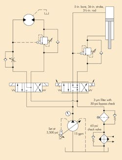

A system's bore cylinder experienced pronounced chattering when lowering the load with less speed using the proportional valve.
A distributor’s sales engineer asked us to troubleshoot a problem he was experiencing with a system he designed. We were not told what the machine did, but he gave us the schematic shown below.
The problem involved chattering that occurred every time the 5-in. bore cylinder extended to lower the load. He explained that if he adjusted the counterbalance valve to control the cylinder on its downward stroke when the proportional valve was wide open, everything worked fine. However, when he slowed the cylinder down with the proportional valve, it caused pronounced chattering, and he could not make any adjustment that worked.
Our work started by checking the model numbers of the components he was using. We determined that the pressure and flow ratings seemed to be sufficient for the application. We then turned our attention to the 30-gpm return flow when the cylinder was retracting. However, this had already been taken into consideration, so that was not the problem.
Next, we looked at the proportional valve, which had spool position feedback, even though it was not shown on the schematic. After some discussion, we ruled this out as a cause of the problem. The proportional valve had an asymmetric spool, which required the rod side of the cylinder to be connected to the B port, and it was connected as such.
Based on this information, what do you think was causing the chatter when lowering the load at less than full speed, and how would you resolve it?
