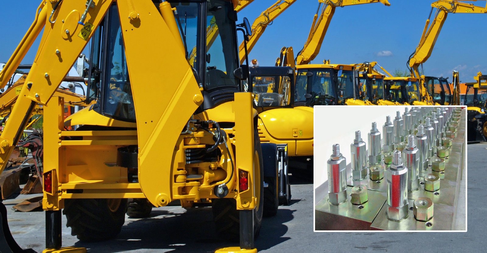

Space on mobile equipment is often hard to find with manufacturers squeezing ever more content onto their equipment. With all the added features and componentry, weight is often also an issue, particularly if it degrades a machine’s operating capacity. Recently, HYDAC developed a line of miniature screw-in cartridge valves following the principles of the common-cavity system. This line was developed to address the growing needs for smaller, lighter products without compromising performance.
This miniature valve line is nominally size 06, whereas the smallest common cavity is size 08. Access to a valve line that accommodates flows less than 5 gpm  at working pressure to 5,000 psi is beneficial to equipment manufacturers as they look to improve performance and efficiency while conserving space and money.

Counterbalance valves are critical for safety and must be able to operate smoothly, close quickly, and prevent movement. Nowhere is this more critical than with aerial work platforms, where weight poses a special challenge for designers. That’s because designers want the hydraulic valves close to the actuators to maximize safety and controllability while operators work high above the ground. But doing so can limit load capacity because every pound of hydraulics installed on the lift reduces load capacity by a pound.
By specifying size 06 counterbalance valves and size 06 proportional solenoid valves, the hydraulic system becomes much smaller and 50% lighter than would have been possible using even the smallest common-cavity valve. The small size and light weight of the assembly allows mounting the manifold within the upper structure for optimal installation, plumbing, and performance.

Another application that can benefit from size 06 cartridge valves is the ability to quickly and easily couple and uncouple different attachments, excavators, front loaders, and other versatile equipment. The environment for attachment manifolds can be quite severe, often operating at high pressures in dirty, corrosive environments in a wide variety of weather extremes.
The small size and light weight of size 06 valves makes them well-suited for use in coupler circuits at hydraulic pressures to 5,000 psi while withstanding shock and vibration. A simple coupler manifold using size 08 may be too large to mount in the space available. Using size 06 valves can reduce the space envelope by 25% and cut the weight in half.
