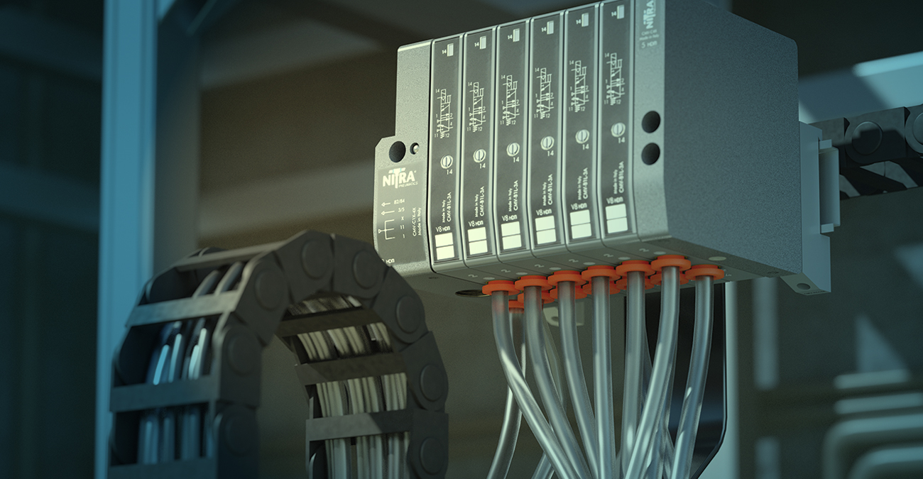

NITRA compact modular valve

Compact Modular Valves
Compact modular valves are often the best choice for automated machines with multiple pneumatic motions, and there are many features to consider when specifying them (see table). These machines often require the performance, flexibility, and modularity provided by multiple valves due to the machine cycle rate and number of actuators.
Distributing multiple valve manifolds around a machine can shorten air lines to cylinders and actuators, resulting in simpler integration and faster actuator response. An industrial environment also requires simplified plumbing, sturdy mechanics, a high degree of protection, and integral control signal routing.
Ease of assembly is often a driving factor on any machine or piece of equipment. The design of some compact modular valves, whether stacked together or mounted to a multi-position manifold, include built-in captive screws in a valve for easy assembly. Designs where the manifold can be split in the middle, without disassembling multiple valves from one end, speeds adding valves or replacing worn valves during maintenance.
Rugged mechanical design ensures a long operating life in harsh service. A valve enclosed in a reinforced protective shell can act as a shock-absorber and prevent the infiltration of dust and dirt. A smooth, rounded valve design should also be considered for applications requiring frequent washing.
For valves to survive in an industrial setting, they must have the appropriate environmental rating. Some valves don’t include protection from dust or liquids, while others have a dust-proof enclosure but are vulnerable to liquids. If protection from dust and liquids is a requirement, valves with an IP65 rating should be specified for protection from dust ingress and low-pressure water jets. A rating of IP67 or higher should be considered if immersion in water is possible.
Modular valve banks offer a variety of configurations from 1 to 32 solenoids. This range fills a variety of applications but 8 to 16 solenoids is a more common range. It is best to have valve banks that support mixed valve sizes supporting different tubing and flows as some actuators will require more air flow than others. Common port and tubing sizes on automated machines range from 5/32 to 3/8 in., and 4 to 10 mm.
To simplify plumbing installation, all the pneumatic connections should be on one side of the modular valve bank and include built-in push-to-connect fittings. While main air supply and exhaust is usually fed to one or both ends of the manifold, connecting the control air to the cylinders from a single side of the manifold simplifies installation (Fig. 3).
