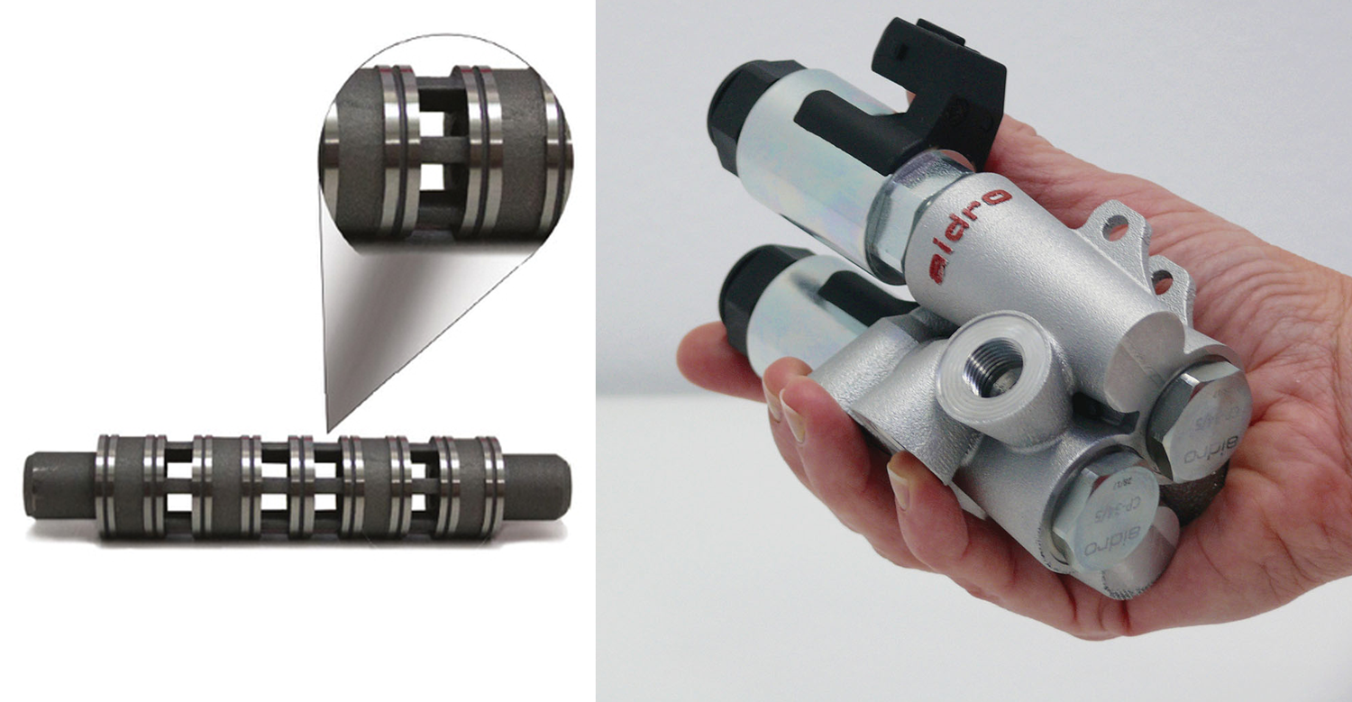

Aidro redesigned a valve spool to be 3D-printed with new hole forms, replacing round holes with square holes (Fig. 6). This increases the area of the oil passage inside the spool and reduces pressure drop.
6. The original valve spool (left) had round holes, required with CNC machining. The spool redesigned for 3D printing has square holes with larger area to reduce pressure drop. (Courtesy of Aidro SrL)
