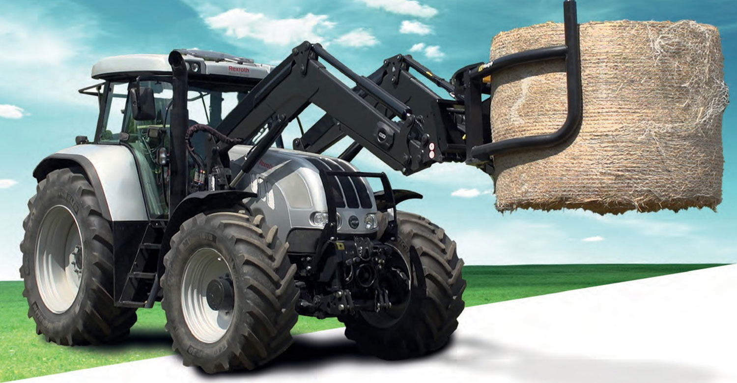

Rexroth e-LS tractor

A new generation of technology is bringing improvements in intelligence, performance, and efficiency to hydraulic pumps.
The operation of mobile equipment usually requires compromise. In particular, hydraulic components are generally on fixed settings (e.g., the pressure setting of the pump), which cannot be managed and regulated in the field. Tractors present a prime example. They have to support a wide range of implements and their hydraulic systems are often set to levels that represent the best compromise for most circumstances. As a result, these implements are not always working at optimal performance, speed, and energy efficiency.
For example, systems with fixed-displacement pumps always undergo high pressure drops—that is, the excess pressure needed to compensate for resistance in the system oil flow. When actual oil consumption is low, these high pressure drops waste energy.
