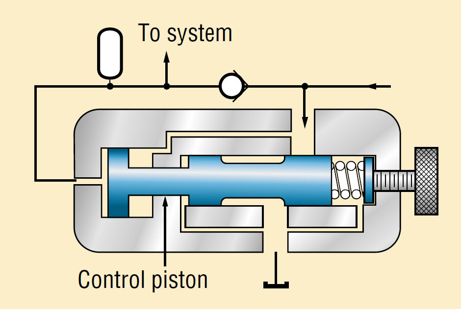

Piloted unloading valves. Unloading valves are also made with a pilot to control the main valve (Fig. 8). A port through the main valve plunger allows system pressure to act on both ends of the plunger. A light spring plus system pressure acting on the larger area at the spring end of the plunger holds the valve closed. A built-in check valve maintains system pressure. When system pressure drops to a preset value, the pilot valve closes. Pump flow through the port in the main valve spool closes the valve.
8. Piloted unloading valve has piston with pump pressure at both ends.
