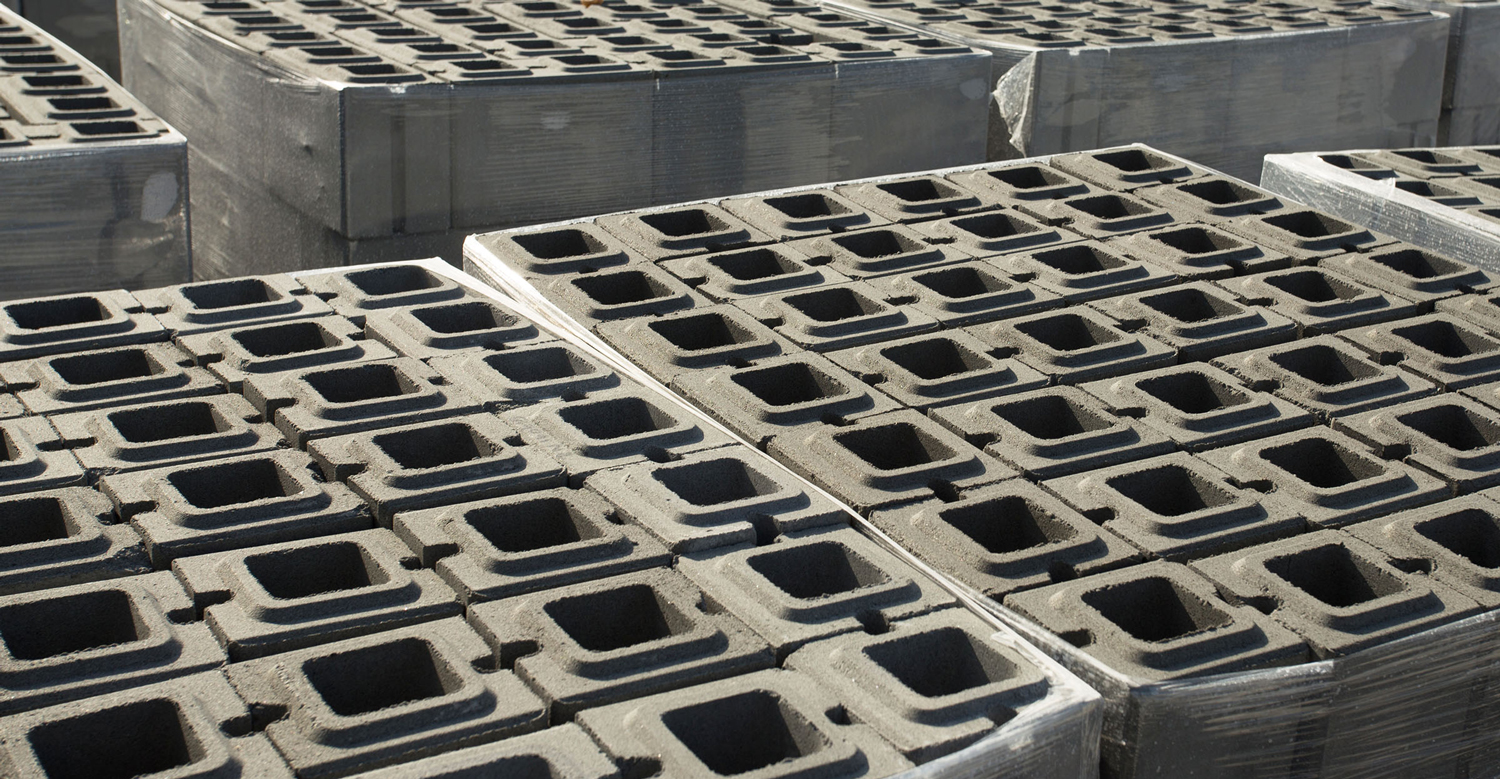

A company that makes concrete blocks has a carousel with 10 horizontal two-piece molds that are clamped together, one at a time, by a 3-in. bore, 15-in. stroke hydraulic cylinder. Concrete is then poured into the top gate to fill each mold. The clamp cylinder and mold are then moved to the next position on the carousel by a hydraulic motor. The circuit provided shows the transfer motor and only one of the 10 clamp cylinders.
No more than two mold clamp cylinders move at a time. One opens while the other closes. Once the mold that’s opening trips a position sensor, the motor turns the carousel. After a dwell time needed for the concrete to harden, that mold is opened and a block removed. The cycle then repeats unless someone trips a safety-light curtain.
A problem occurred when a freshly filled mold would open slightly, allowing concrete to leak from the bottom gap of the partially open mold. This happened when the carousel first started to rotate resulted in a rejected block because of the void created.
Any idea why the clamp cylinders didn’t always do their job?
